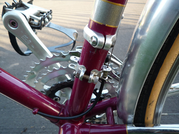

Interesting about the front derailleur. This one wasn't positioned correctly when I got the bike.
Hi again, I just had a look at your photos very nice bike love the colour and interestingly noticed the route of the gear cable to front derailleur just like the one I worked on but I rerouted it under the frame like the other cable that runs to the rear derailleur thought this looked better and less likely to catch on shoes or clothing etc, with your bike in such good condition I reckon the BB will be a doddle.......
My friend's friend has collected the bike but will be returning it next weekend for me to fit mudguards so will get some photos then, I've put the cable under the BB shell and up behind the the seat tube like you see in most racing bikes only the galaxy dose'nt have the plastic cable holder which normally screws into the BB shell, will send you photos next week. by the way when I say BB shell I'm meaning the frame where the BB goes not the BB itself.... cheers
That cable routing is perfectly normal and correct for that frame.
Many frames used this route. It keeps the cable out of the elements but does require the front mech to have its own cable stop or at least for some, an extra cable stop if the mech doesnt have one.
The angle is possibly better for shifting too as its not so accute as under the BB.
Checked my photos, and that's how mine sat.

Well done on the BB and seat tube, I mentioned the cable for front mech as a ref to what I did knowing that your pic showed the correct way of its time (like the one I worked on), changing it is personal preference of course, you don't end up with too acute of angle on the cable but you do need a longer outer cable, I must admit the galaxy cabling(mine) didn't look as good as the frames in Legrandefromage photos,Have fun....
