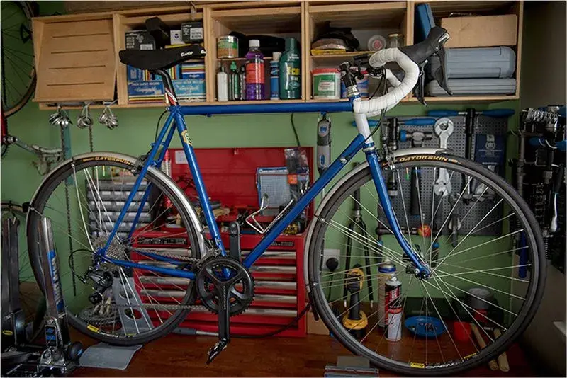

It's been a few weeks since I got the painted frame back from Dave and I've been agonising over what to build this bike with. I've been holding out for a NOS 80s/90s Shimano group but haven't found. I'm so keen to crack on with the build and ride this frame so I've gone with a brand new 11 speed Ultegra build. The frame was built for 700x25 tyres with mudguard clearance... and thankfully, everything fits... just!

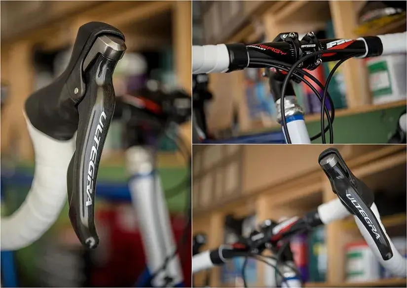

Ultegra 6800 levers with Compact bars (Compact bars was Dave's recommendation to get the fit right. I needed a shorter top tube but didn't want to build too short to not run into problems with mudguards.

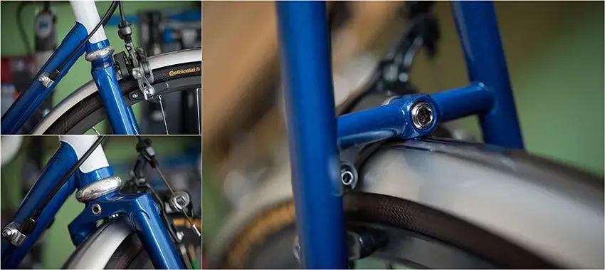

I think the clearance was spot on. It is very tight under those calipers but the idea of building threads into the bridge and crown to mount the guards has saved on space without having to have too much clearance.

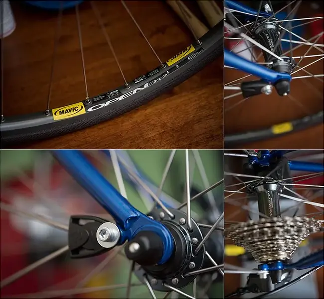

Ultegra 6800 11 Speed hubs and Mavic Open Pro rims

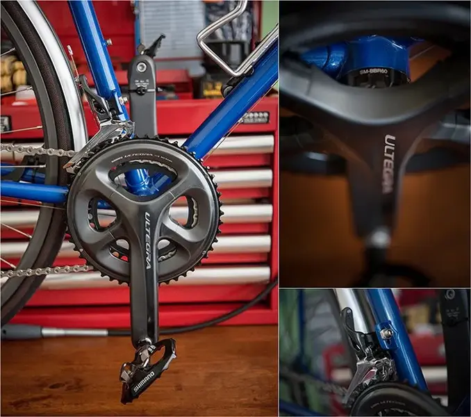

One of the biggest worries I had was if I had brazed the front mech in the correct place but I've got it spot on for the compact chainset, 50T ring and should go up to 52T

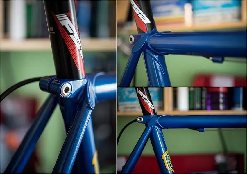

The part of the frame I am really happy with is the seat lug and stay caps.
The bike is built and is going on a shakedown ride this afternoon. I'm also designing some decals for the head tube and down tube to finish it off.
I feel like I've sold out a bit with the modern components but I really had to get it built and ridden. I couldn't bring myself to go with modern wheels so I hand built my own wheels with Swiss DT spokes and Mavic Open Pro rims.
