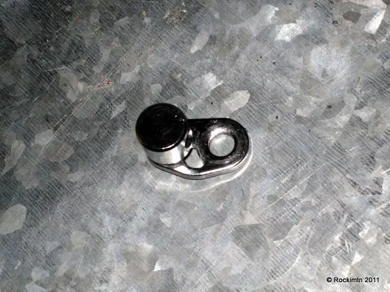

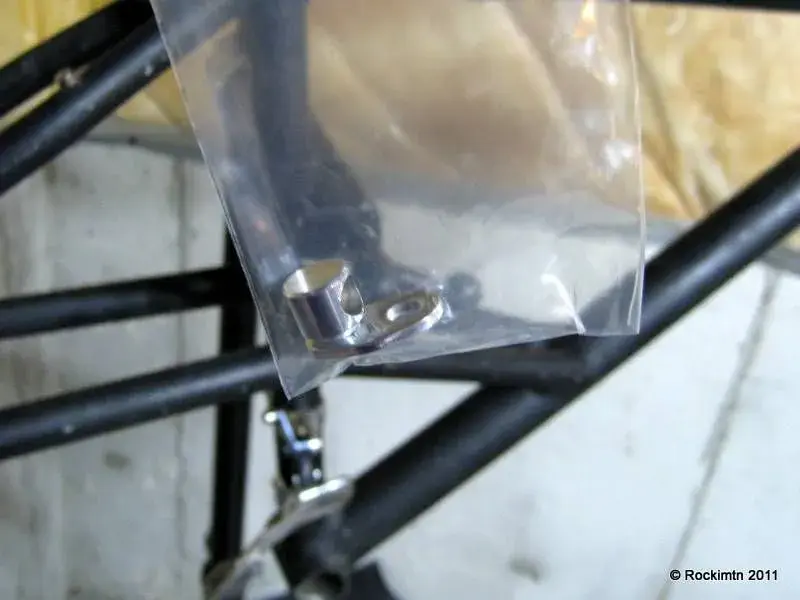

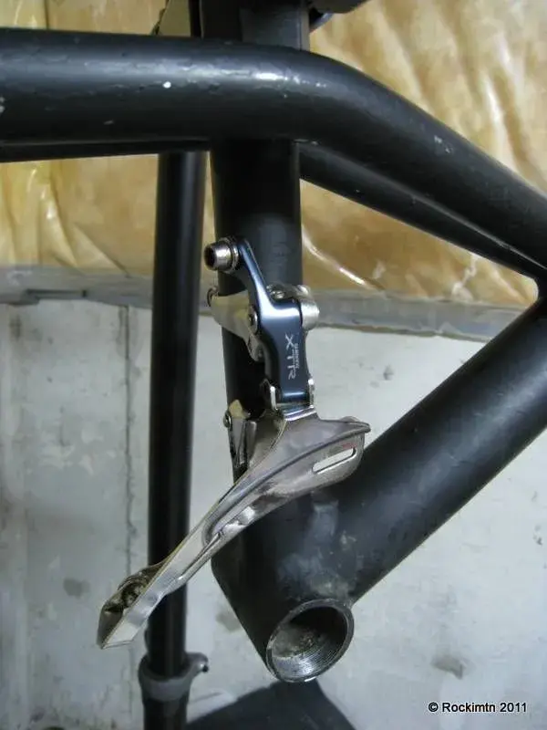

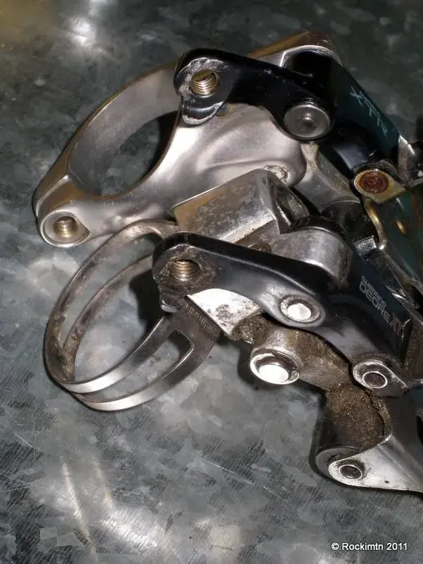

*Argh*… now I know why this brand is called FUNK. I've cursed a similar word several times now trying to get this project moving forward. First the cracked XTR headset crown race. And now this.
So earlier in the week, scored some XTR parts locally and one item happened to be a lovely f. mech with proper band size and pull. Today received the required NOS f. derailleur cable stop. Went to fit and low and behold, the XTR has a tab that's too wide to fit the slot on the cable stop arm. :roll: checked an XT f. mech (which isn't the right band size) and it fits. *sigh* FUNK ME! :(

I ran into the EXACT same problem with my Trek 8700 Pro!! You can usually find those pieces on u-brakes or road bike parts. I was lucky to have 2 shops in the local area that specializes in pick-a-part still bike parts. Got it for like a $0.25. Good Luck and subscribed to this thread!!
Go Canada Go!
only 25¢? although it didn't break the bank, i'm embarrassed at the amount i paid for mine in comparison. :oops: :lol:
i see yours bolts in squarely in the centre of original hole, while mines is connected with an arm.
now should i source an XT f.mech or another cable stop. :roll:
