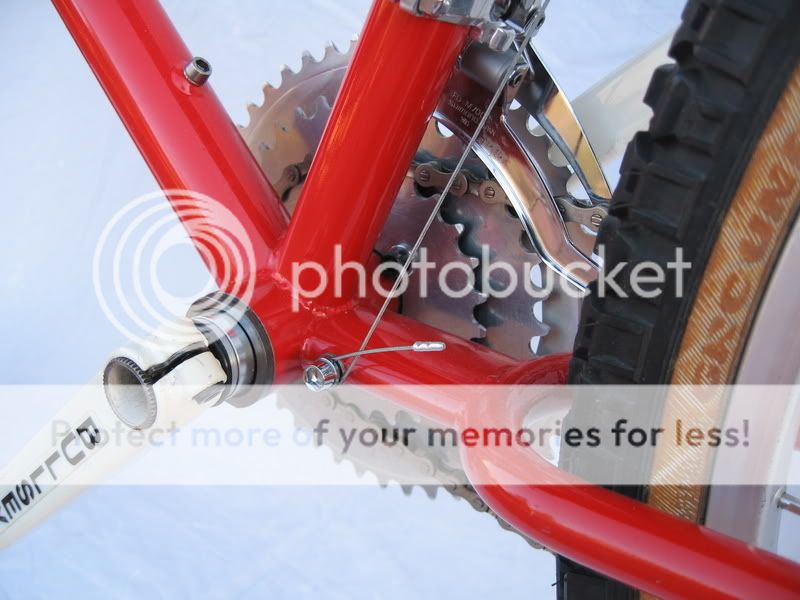

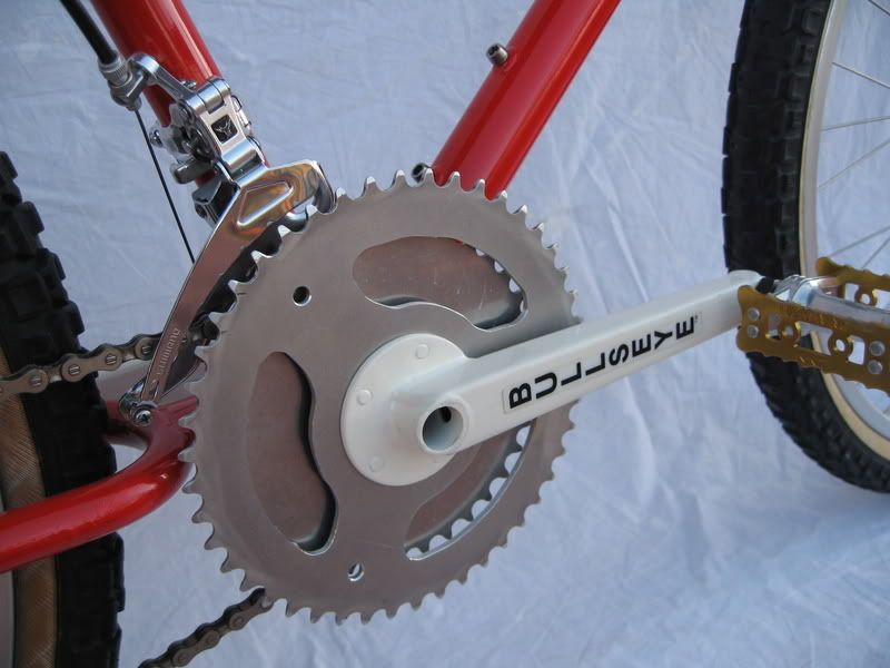

mine is an early 1, 1990. what you have there looks very similar. the front mech outer goes down to the mech & the inner in bolted to the bb shell. i'll try to get some pics for you.
thanks for that! would appreciate seeing how yours is set up. did some searching on FUNK here but didn't get as far back as your thread. lovely bit of history you have on yours.

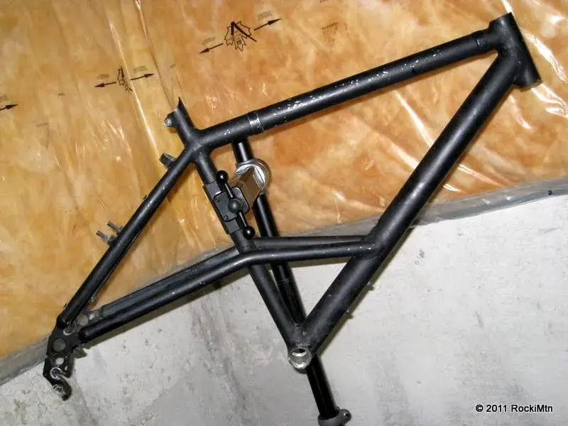

went to strip off all parts so that i can strip off the paint. the bb was a little tough to get going but was fine afterwards. the un72 bb still had a $55 price tag stuck to it. :lol:

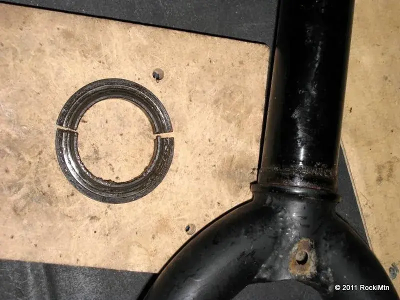

next moved onto the stem, no issues there. fork popped off and proceeded to the HS. lower cup came out by hand. "that's not too good" i thought. :( top needed the normal and expected tap out to remove.
last think was to take off the race off the fork. now having seen/heard that XTR race being somewhat fragile, i was a little hesitant about doing it, but i thought it had to be done so i can strip the fork properly and repaint if necessary. went with a VERY light and gentle tap to get a feeler, and to my dismay… the race split in and half and fell off the fork immediately. this tap was as light as tapping my finger onto table!!! :shock: i was so surprised that all i could do was chuckle and mumble to myself "you got to be kidding me". :lol: so anyone have a spare XTR M902 1-1/4" race??? or a complete headset, doesn't have to be XTR? :(
anyway, frame and fork are now ready to be paint stripped. located the serial number in the drop out as well.

I looked for ages trying to find a screw in cable stop. Didn't find any, eventually had to get them made.
can you tell me where you got them made and how? do you have measurements/dimensions you could share with me?
anyone know of where i could get suitable screw on cable stops for the rear seat stay??? may have to resort to those unsightly double side tape/zip tie jobbies. :?
the front derailleur set up is the same/similar to that used by Yeti at the same point in time. Searching for a Yeti set up should yield a photo or two.
Screw in cable stops can be made out of a hex head bolt without too much effort. Start by lining up the guide holes with the bolt in the frame (use a thin washer between the two). Drill a hole through the head (off the frame) and then machine the head round. Alternatively you can just drill a hole in an Aluminium allen bolt as a quick fix.

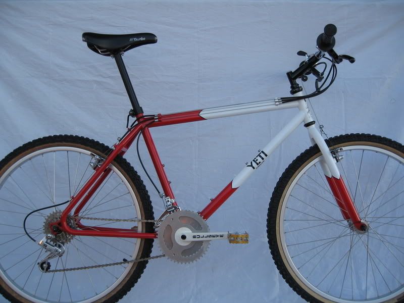

Actually to save you a bit of time the front derailleur set up will be very similar to these:
Looks like it's missing another cable stop on the back of the seat tube, like this one has:
...which would mean that the front mech is a bottom-pull, so the cable runs from the cable stop down, round the pulley and back up to the front mech, Orange Clockwork -style.
