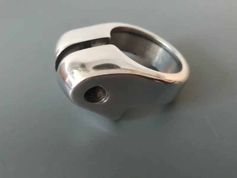

That's better still a few tiny marks to lose...I'll be doing one last big polishing session of all the shiny stuff before the final build.
Fits well and seems to clamp an absolute treat,happy days,!

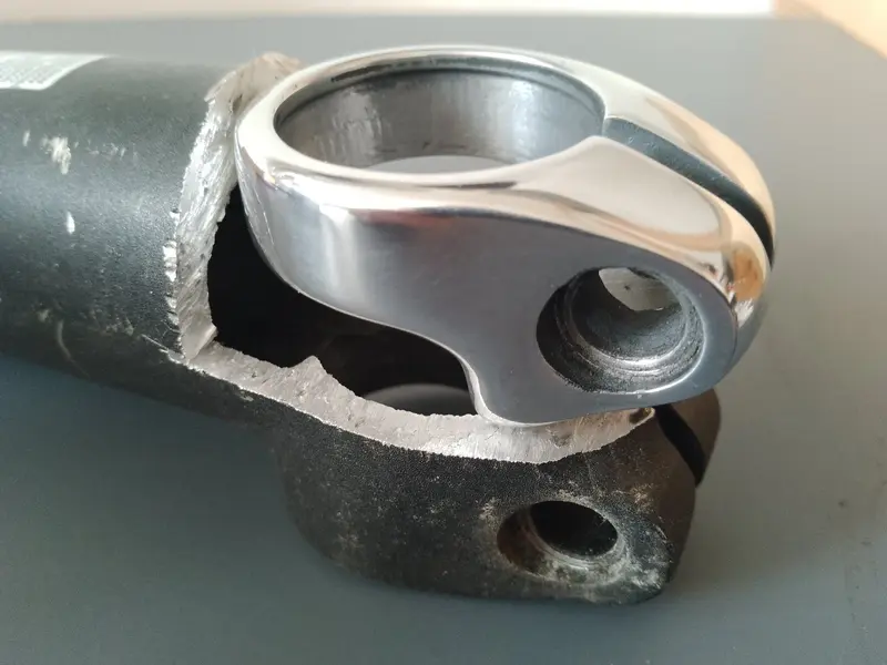

Next pic is where it came from...
Not quite alchemy... however I guess it's saved around £15 of the budget!

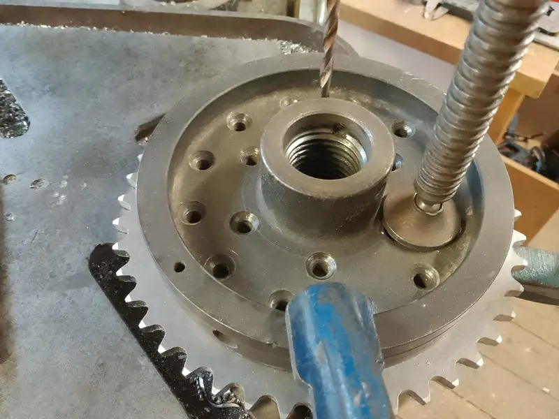

Took about an hour of shuffling tweaking measuring and cursing to get it centred....
3 bolts,3 stud's and 3 hail Mary's latter and it spins true...
This might take a while...
That's the business side nearly done!
That's the back side the bit you don't see 😂
I think my flange is flat..fnnarr ...and my register is good...
But the proof will be in the pudding as they say and I won't be trying the pudding until it's finished...
Tomorrow I'll tweak the side profile of the teeth with just a little taper I reckon...then flip it over and treat the teeth to the same attentions then part it out of the blank and just like that we'll have a custom ring ting thing innit!

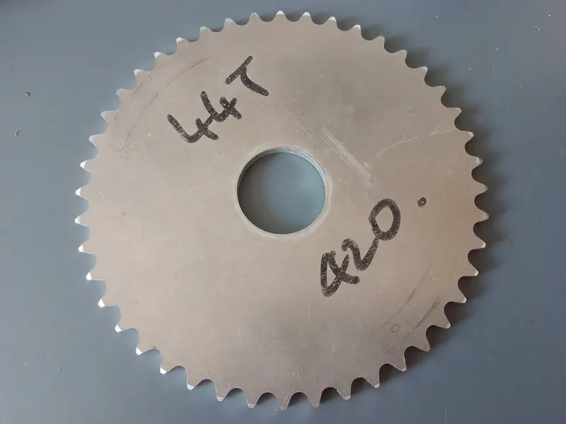

Wish it had been a 45 tooth....could of done some cool things ....45 teeth ...5 bolt pcd...instant indexing!
