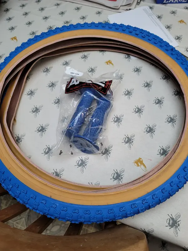

Custom Burner if I was to build it without the worry of old parts🤔

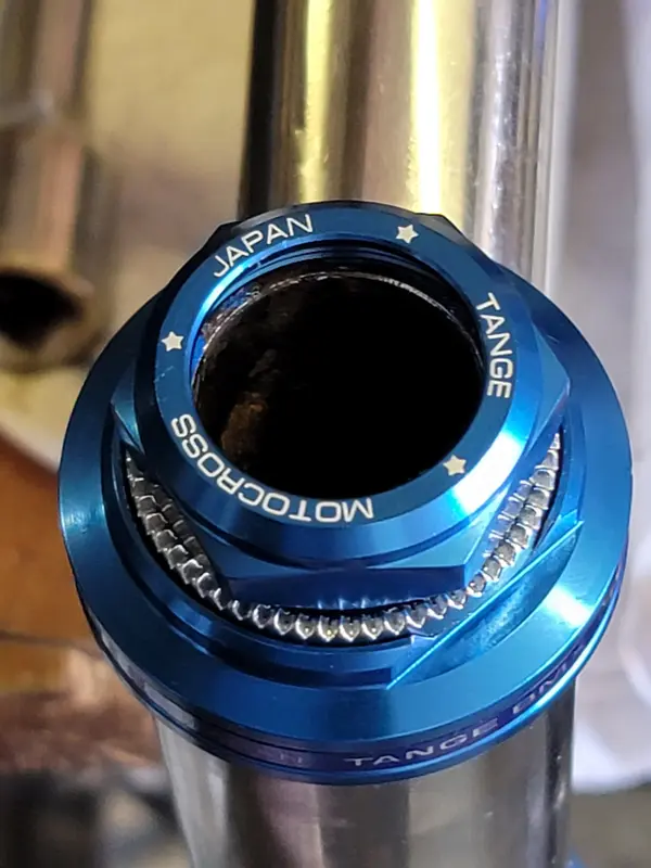

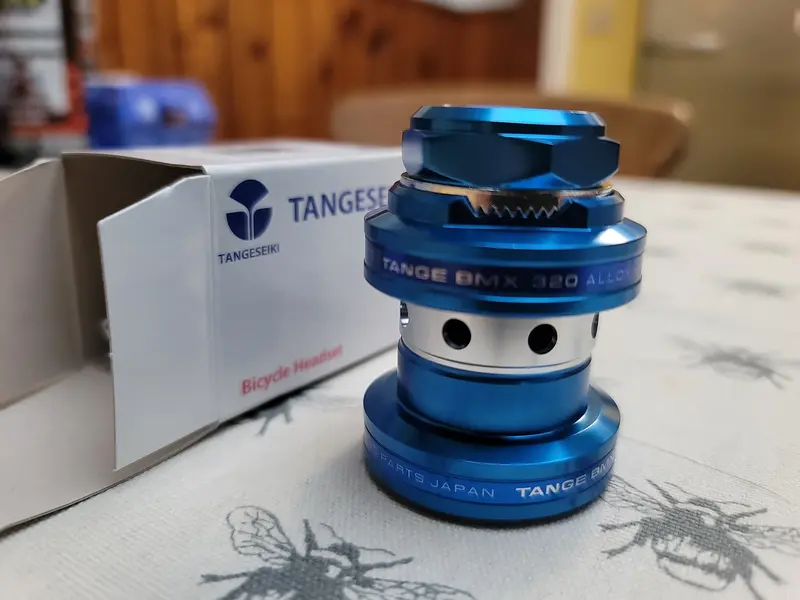

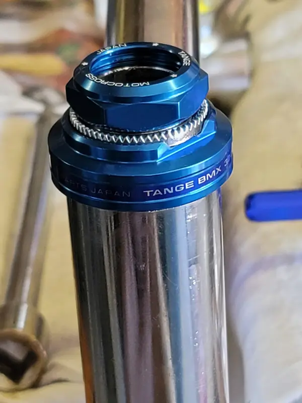

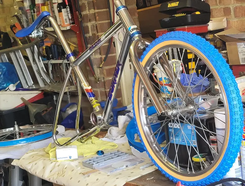

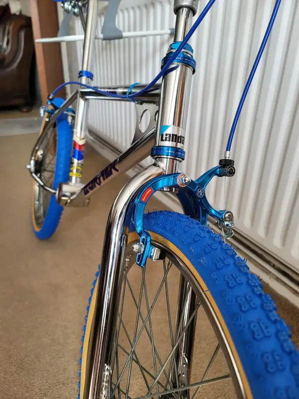

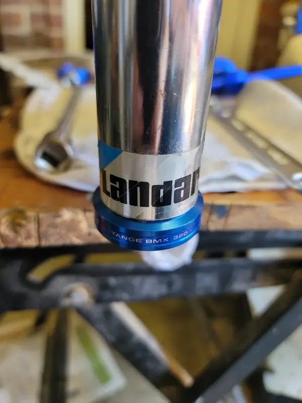

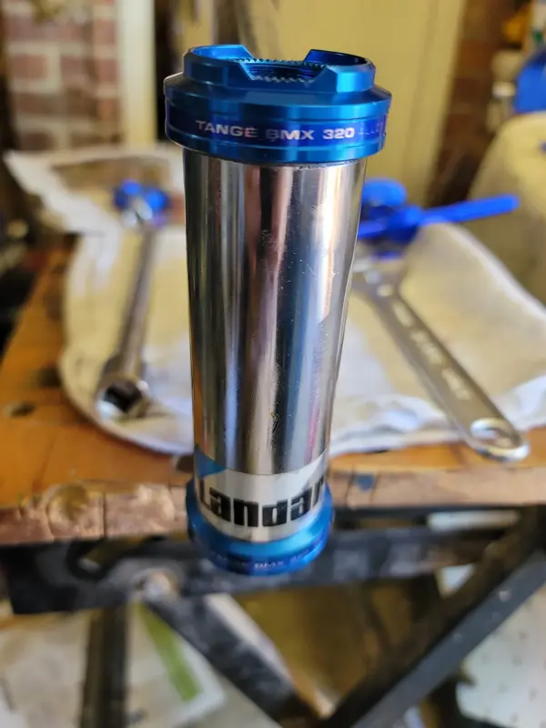

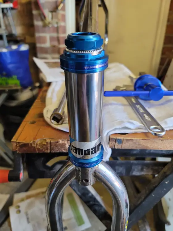

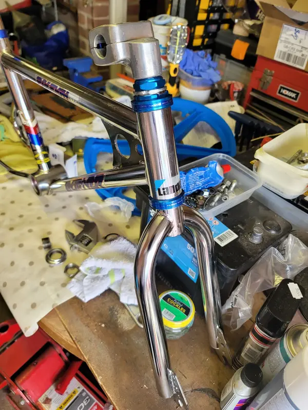

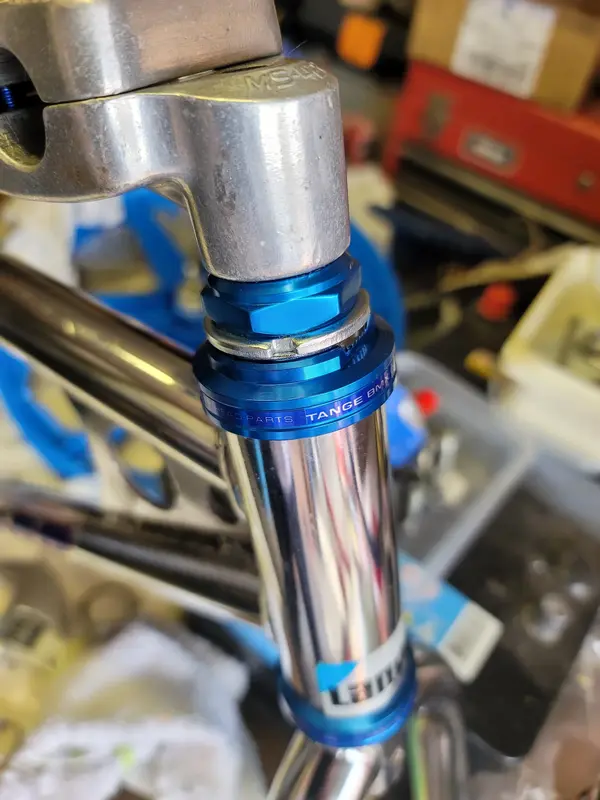

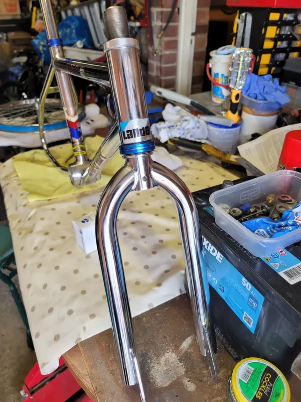

Loving the blue Tange headset, its perfect for the MK1 Burner MX320! :cool:
Matches the dark blue theme but some parts just have a diferent blue and will never match properly sadly.😢

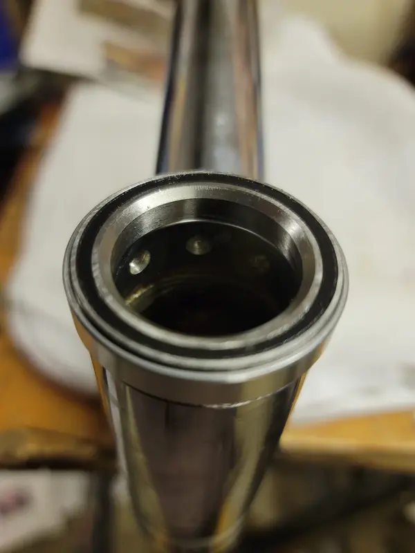

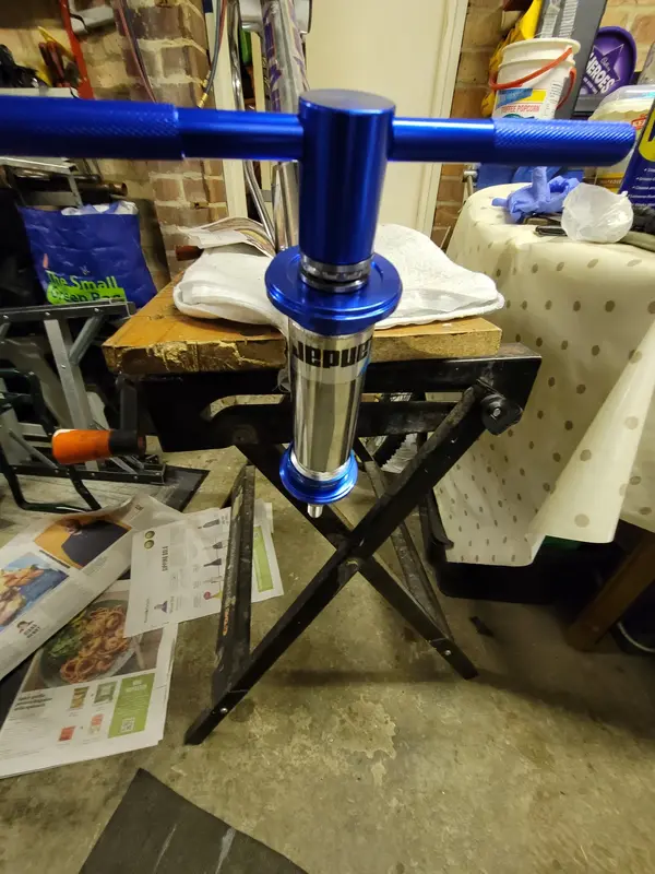

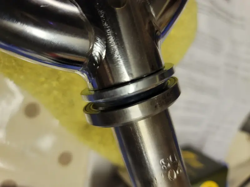

Remember to take out the sealed bearing before you press these in, you don't want to ruin the bearings by crushing them bottom and top.

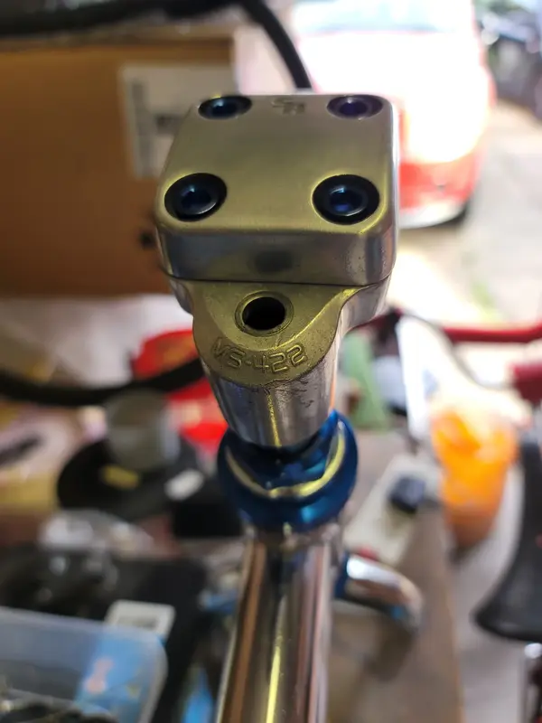

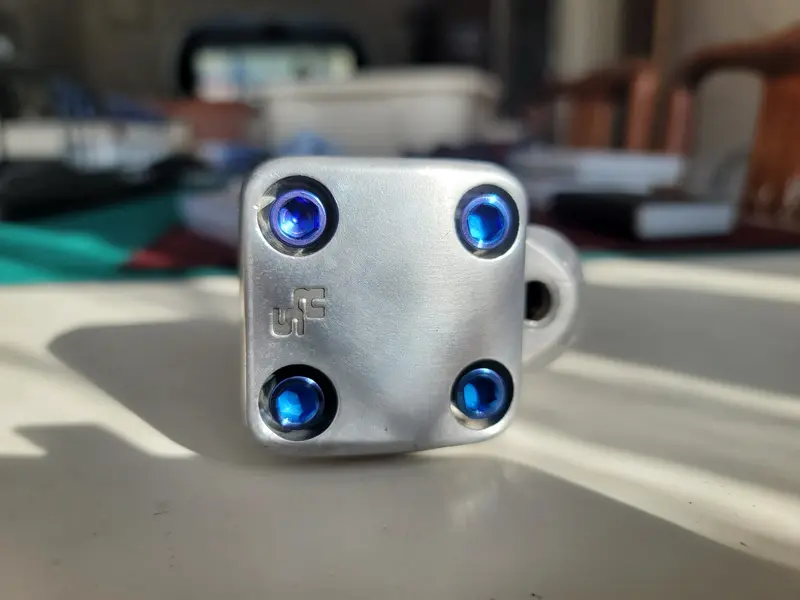

Titanium bolts, the suntour stem started to float sorry takin a break soon

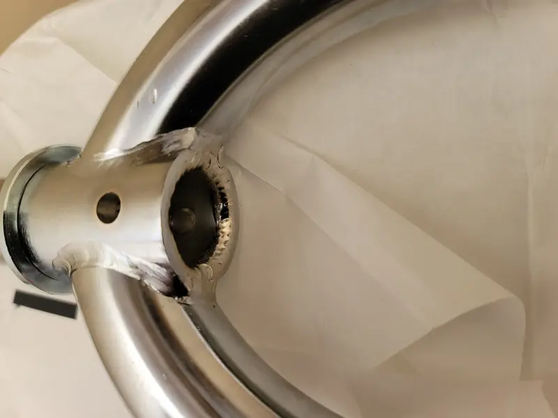

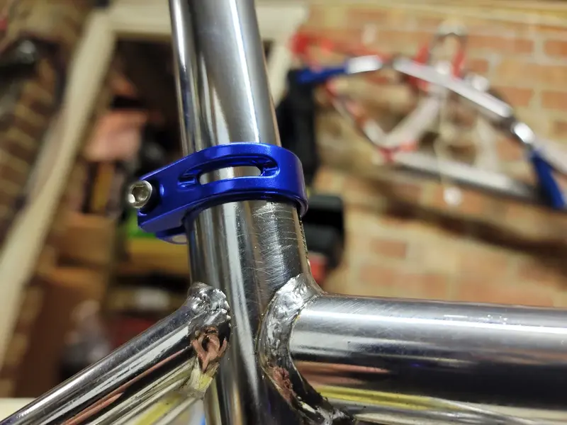

Small updates: The seat post hole was smaller than than the new seat post, so decided to fix it.
Rolled up sand paper foam pad and lots of WD40 for lube!
Used the Alu post as a marker on how larger the diameter was getting and by an hour it slid up and down like siken smooth Tofu.😂

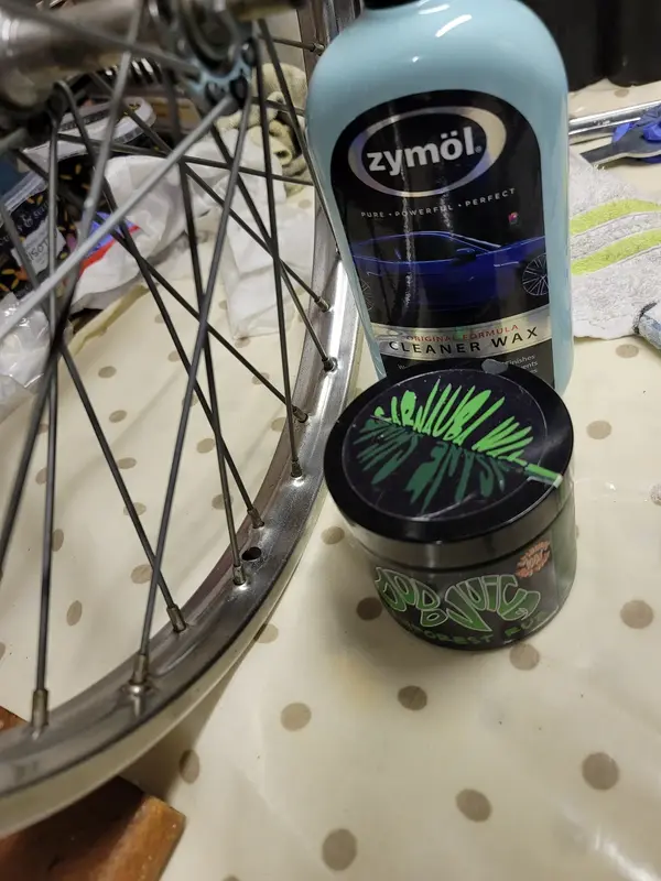

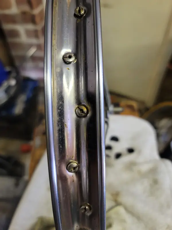

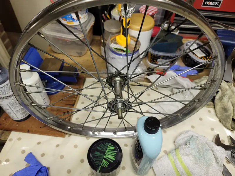

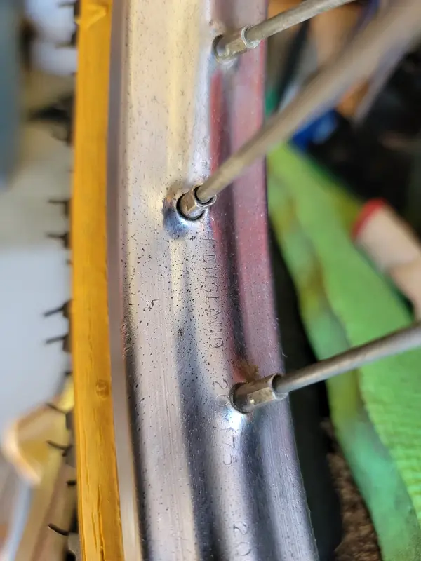

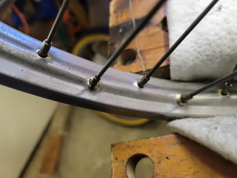

Cleaned up one wheel, but the rear is worst so will take time!
Its a geniune Raleigh wheel which surprised me, shame its pitted needs Rechroming🥲
I used my combo of Zymol polish and Canubba Wax and realised the stuff cost more than parts😬

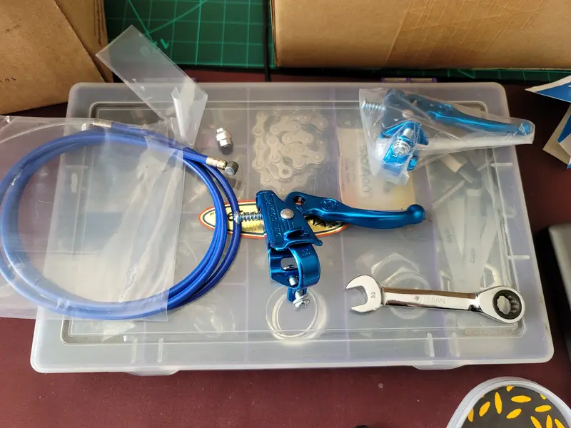

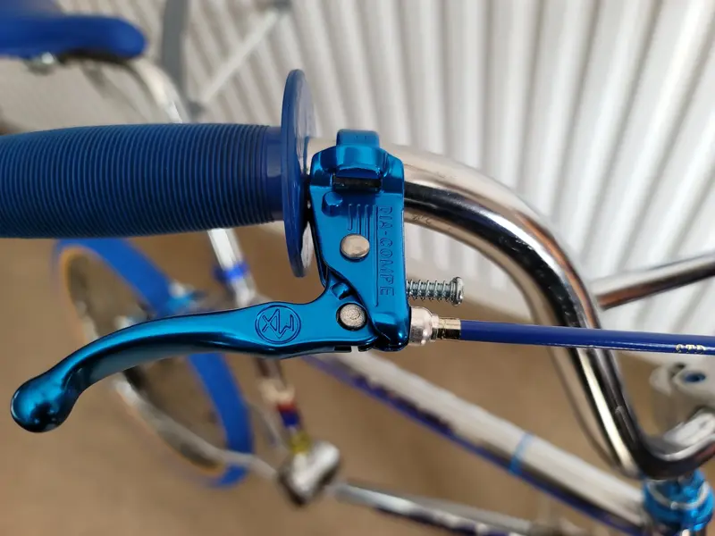

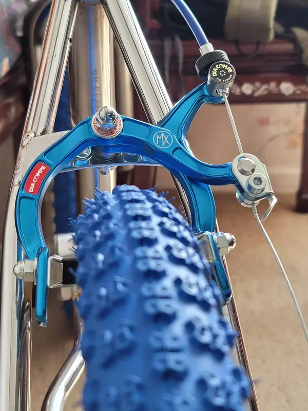

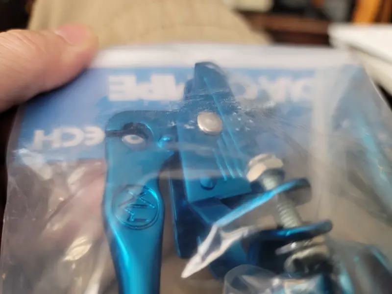

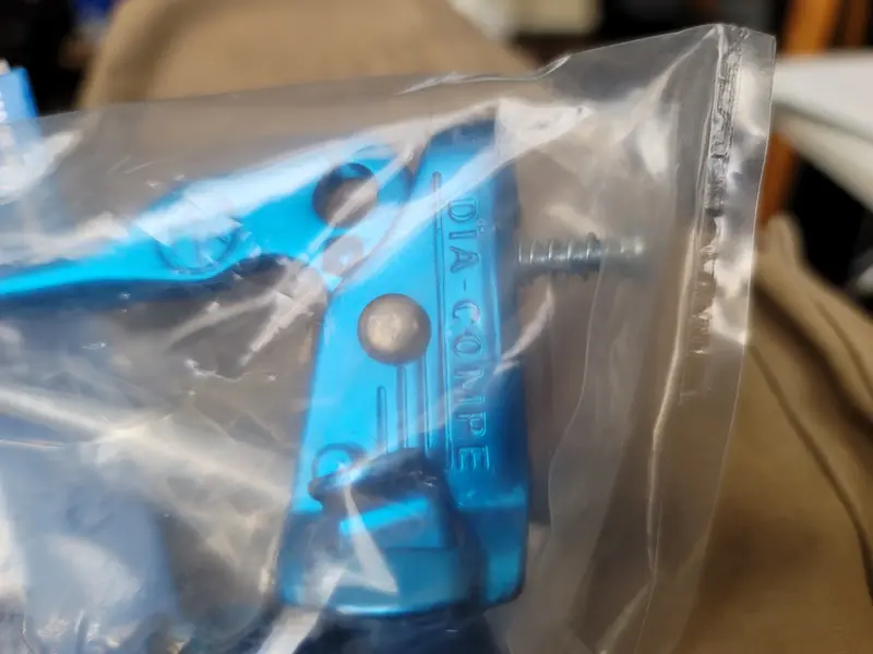

My brake levers came nice dark blue Dia Compe Tech IV's
That's one wheel completed and it's the best I can do without rechrome. I looked at all the other possibilities new rims, but they are all anodised Alloy and not really period.
I made this mistake with the Nightburner. The solid chrome re pop are crazy monies right now 200 royal FK your pocket 🤐

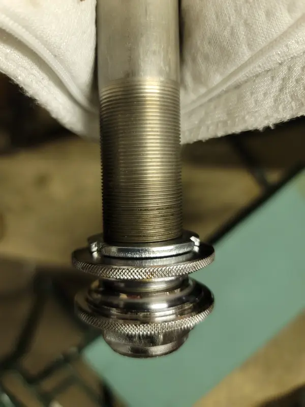

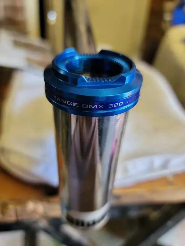

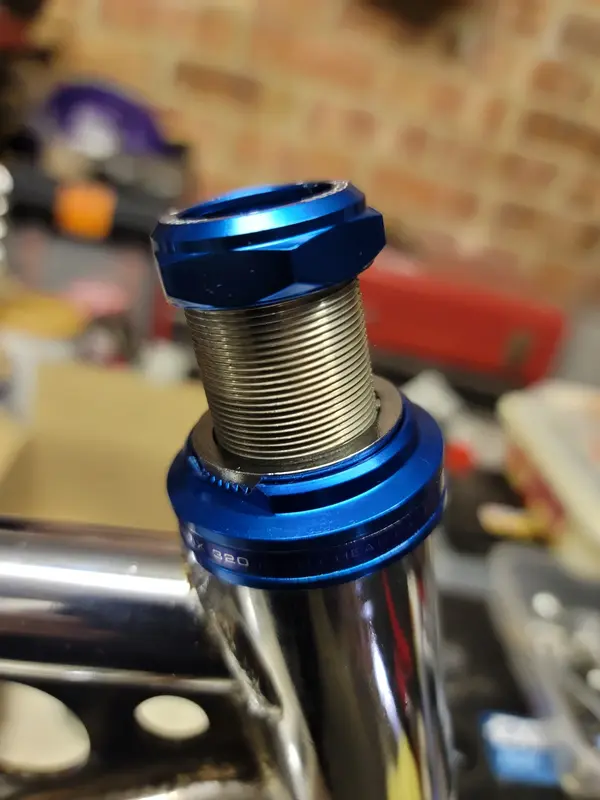

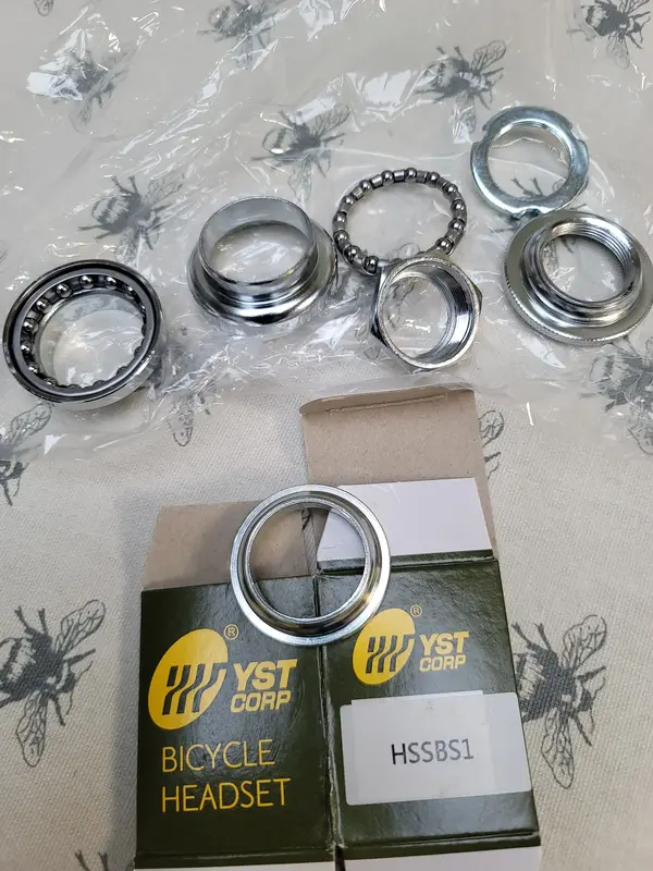

Wanted to ask others do most people run 27mm crown racers and still fit well on the Tange-Seiki headset bearings? As mine came with a 26.4mm lower crown. I'm asking as I have 27mm mounting lip on the new forks?
I could just rub down the microns on the forks to make it fit?

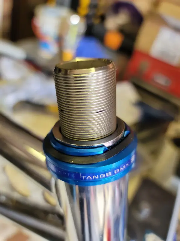

Then I've got to cut the 1" Threaded head so the Tange locking nut meets the head flush.
Can't do one without the other!
So made loads of progress today the YST spare headset came with the 27mm crown racer. Crazy I had to buy the whole headset because it was cheaper than sourcing a single 27mm bottom crown racer.😮‍💨
The fettling of height started and I measured about 3mms spare thread just in case I can always cut more if needed.
I used the old lock washers and headset caps to set the markers so they acted as a great guide for the hacksaw. Completely clean cut and no issues, a bit of sharp blurr to file off. Oh I used the old head sets to re-thread any cross cuts on the thread, as it unwound off giving me a clean thread afterwards.👍

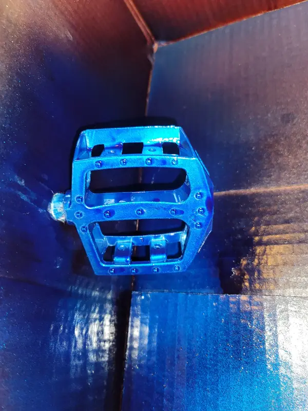

Pedals I have two sets original and another I'll see which I like.

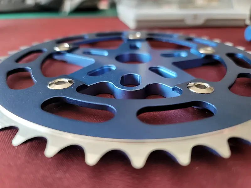

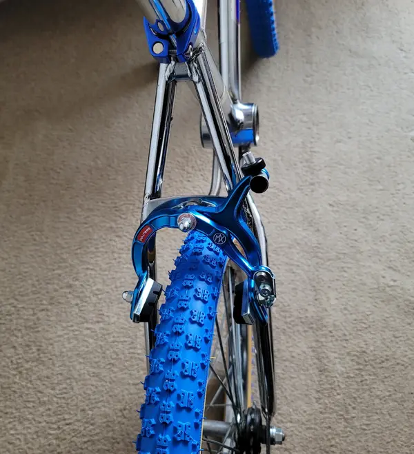

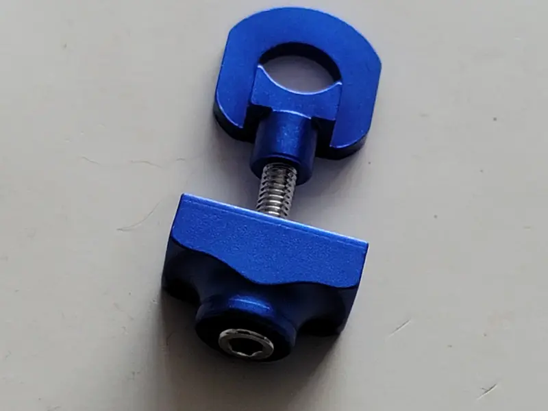

Nice and clean fitting the brakes, what I should have done was the chain and freewheel, set the back wheel. Then adjust the brake blocks for truing!
Anyways I'm quite pleased with the quality of the repo's as you can see the colour is dark blue and fitting for the rest of the bikes colour scheme! Worked out they have a quick release to remove the wheel off for punctures nice touch, they didn't just repo the originals they improved by tweaking and increasing the usability.

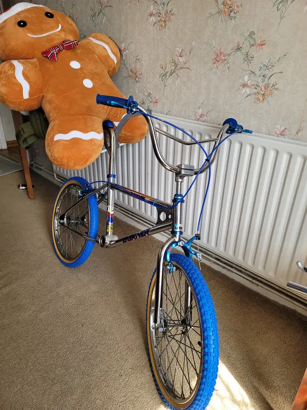

Geralt the great decided to ride the bmx...... he approves 😂
I lost the lock tab washers, can't find them, so another £5.00 for two pairs Whoop Whoop.....!!!
The brake levers are Tech 4's not sure if I like them TBH?
I left the Mushroom grips as I actually like them just feel hard. I'll use the AME's on the CW style bars as they suit that American style much better IMO.
