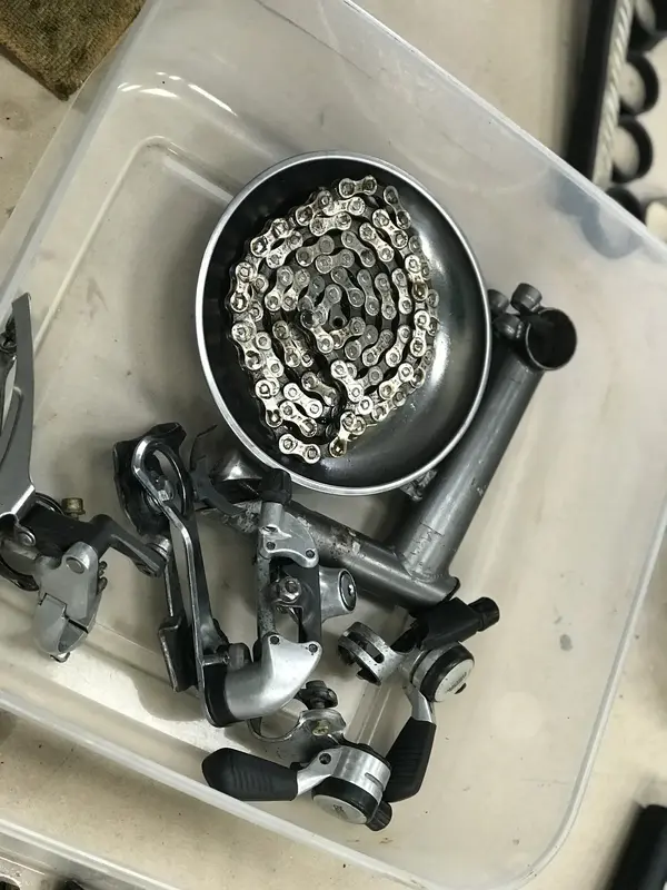

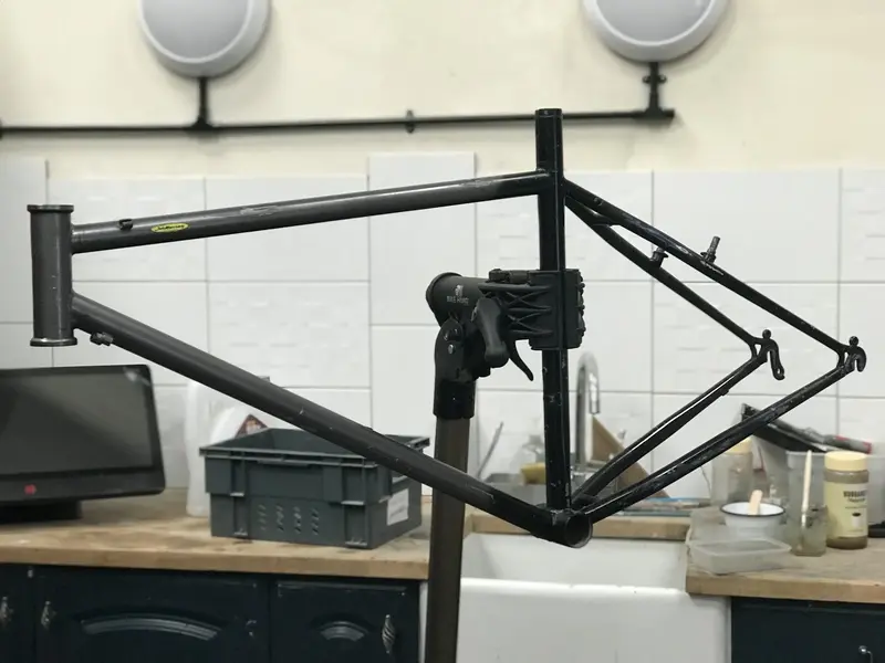

DA6EA1E6-570A-4E9D-BA52-1D032E71E04D.webp 1F956B9A-96C5-4CF0-9297-B7286BAEC764.webp A0E8F596-20F8-40EE-B96D-A16EDFD60B31.webp
Gave the parts a bit of a clean up. Rear mech is looking shiny but left thumbie has a worn logo and doesn’t feel right. Will take the frame to the paint shop to get colour matched and then I’ll repaint the whole thing. I’ll cut out decals from paper and glue them on and then laquer them over, I think thatll work hopefully. Those bars were a pain to get out. Had to get circlip pliers and pry the stem open. Regreased the bb and need to get new headset bearings because the bottom cage has snapped into pieces.

Found a serial number yet?
Try some posts if you have them, Kona's can be an arse around this time as people damaged the Q/R area from over tightening, wrong post size etc.
(as above, why I also have a use and some shims to find sizes and a quick fix).
