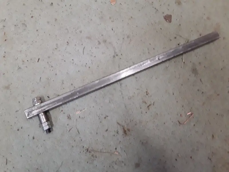

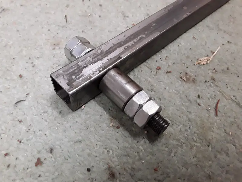

Do you need the highly specialist tool to do this right?
No, £4 b and q or free from any mate with any scrap around the workshop.
Just need a sliding t square to hold on it or worse a steel ruler.
Like the look of that - may have a bash. Presumably need a pillar drill to make sure that bolt is in absolutely plum? The reviews of the £30-50 ones across all brands and sellers describe a lot of play in the tool which has to be accounted for/bodged around. Which appears to defeat the object, especially as probably within/worse than tolerances of my eyeball on my 8 speed fleet! The x-tools one looks more solid, but not sold anymore.
Yes, just make sure the holes are square and a very tight fit. I can only just turn the " handle " once its screwed in, you dont want it floppy. And just remember to measure to relative point on the rim, with the wheel in dead straight....i just measure to where the valve hole is on the rim at all points......as all your really doing is aligning the rear mech hole with the sprockets on the wheel thats in at at the time.....not the hole to the frame, hence the need to have a single point of ref on the wheel.
Hope that makes some sense!
