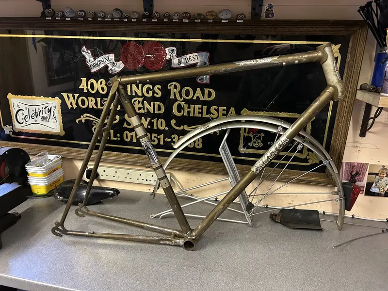

Picked up this old thing yesterday evening, a last minute eBay bid secured it (cheap!) and the B17 saddle on it means I’m quids in either way.

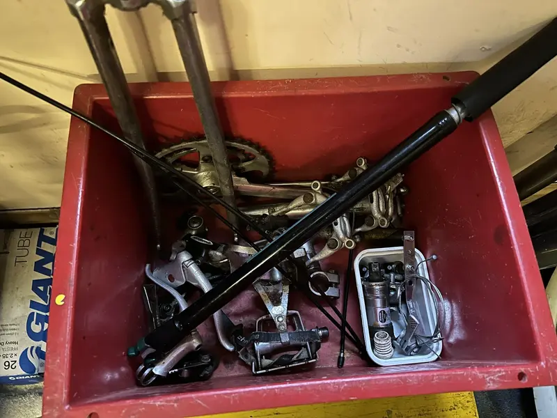

Stripped it down this morning and it has yielded some half decent parts, sr laprade seat post, stronglight cranks and Sachs mechs all look ok.

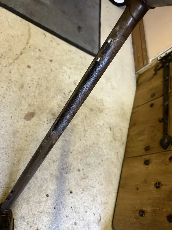

Frame is 531 and light, possibly helped by the tinworm which has eaten the surface in various places. The wire wheel has took off a lot of it but under the top tube I found a pinhole - I gave it a good poke with a sharp point and it didn’t go through.
I think a sanding disc on my grinder will help to further assess the condition. A dab of weld might be enough to save it? We’ll see.
Be nice to save it really, I could practice my painting on this frame and get it looking presentable for very little outlay - it’s my size too which is a touch.
Let me know your thoughts, could be a nice little project for the Christmas break.

Random question, is the shop that sign came from the shoe shop that used to be on the corner of the road down that end of Kings Road? I’ve got a very vague recollection from when I used to drive through there years ago (well, 25+ years ago 😲).
Yes it is! It would’ve been at least 25 years ago. We fitted out the shop as a dry cleaners after it was a shoe shop and found two of these signs in the basement. I was working for my father in law at the time and we kept one each rather than putting them in the skip.

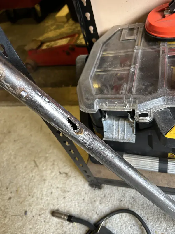

That’s a very kind offer, I might well take you up on that as I’m down your way in early January. Yes, sadly this is too far gone, the frame is so thin that a welder is blowing great big holes in it.

I thought the bb area would be close to failing with that level of corrosion.
I'm not sure I'd recommend mig welding on the mid point of a 531 frame tube though, perhaps lugs only?🤔
At least I don’t have to find that out the hard way now.. ;)
