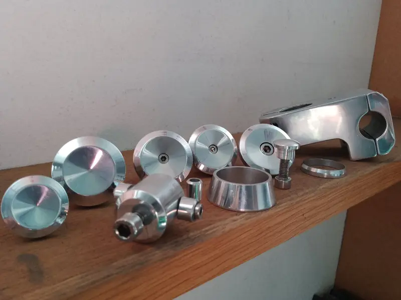

So we're getting nearer the proper mechanical bits ....but obviously it's still got to be shiny with a touch a funk!
One of the fun bits with GT's is getting a straddle cable round the seat post for a u brake...easyish with the original plastic doofer on the bigger frames! But on this little one it's tight as you like...hmmmm gonna try something...it'll either work or....erm not! Let's give it a go Joe!
Start with a little offcut nugget of bar...down to size...just a sniff wider than the seat tube
Ground a tool for a happy snug fit for a straddle cable and got a groove on....er in!
Cut the funky dish....this detail seems to be appearing on quite a few bits....think it'll appear again on others soon...
And do all of that over again for one half the size for the front...
Then drill some tiny little holes at cunning angles so brake and straddle cables dodge each other and drill then tap the threads for the pinch bolts ....aaaaaannnnnndddddd....a damn good polish of course!!!!!
and we have some rather cute straddle cable buttonsperfect duo like the two Ronnie's!

Thought Id clear a special place for the bits so far.....the top shelf....saucy!
