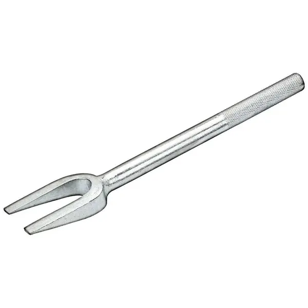

I have a 70s Peugeot that I found in a dumpster behind a bicycle shop. They used a BSA threaded extractor instead of a French thread and stripped the threads and were unable to pull the arms. It was a nice vintage crank set so I removed the arms so it could be repacked by using a small automotive pickle fork tool. It came right off. This is only a last resort because the pounding will put small dents in the back of the arms. You really can’t see the dent but I know it’s there.
