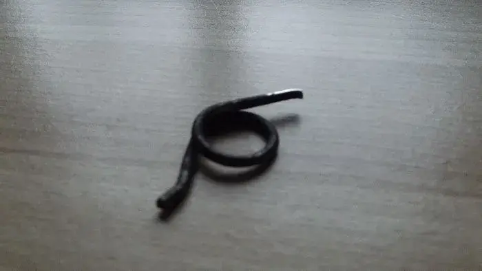

I've also attached a picture of a little spring that is responsible for the brakes returning to their original position, which doesn't seem to be doing its job any more. Does anyone know where I can find parts like this?

Dawes of a certain era used Weinnman brakes. As to wear you find that spring I don't know. Another set of brakes would be a likely source.

And the brakes are indeed Weinmann ones, specifically Weinmann Vainqueur 999. Do you know if this set http://www.ebay.co.uk/itm/Set-vintage-W ... 20befc8714 are similar enough to have the same spring? They seem to be going cheap!

Weinmann brakes go as cheap as chips as they were made in their millions LOL
