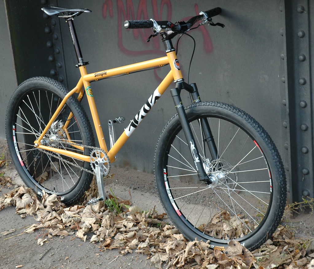

Cotic love here too, had my Simple for 18 months.
