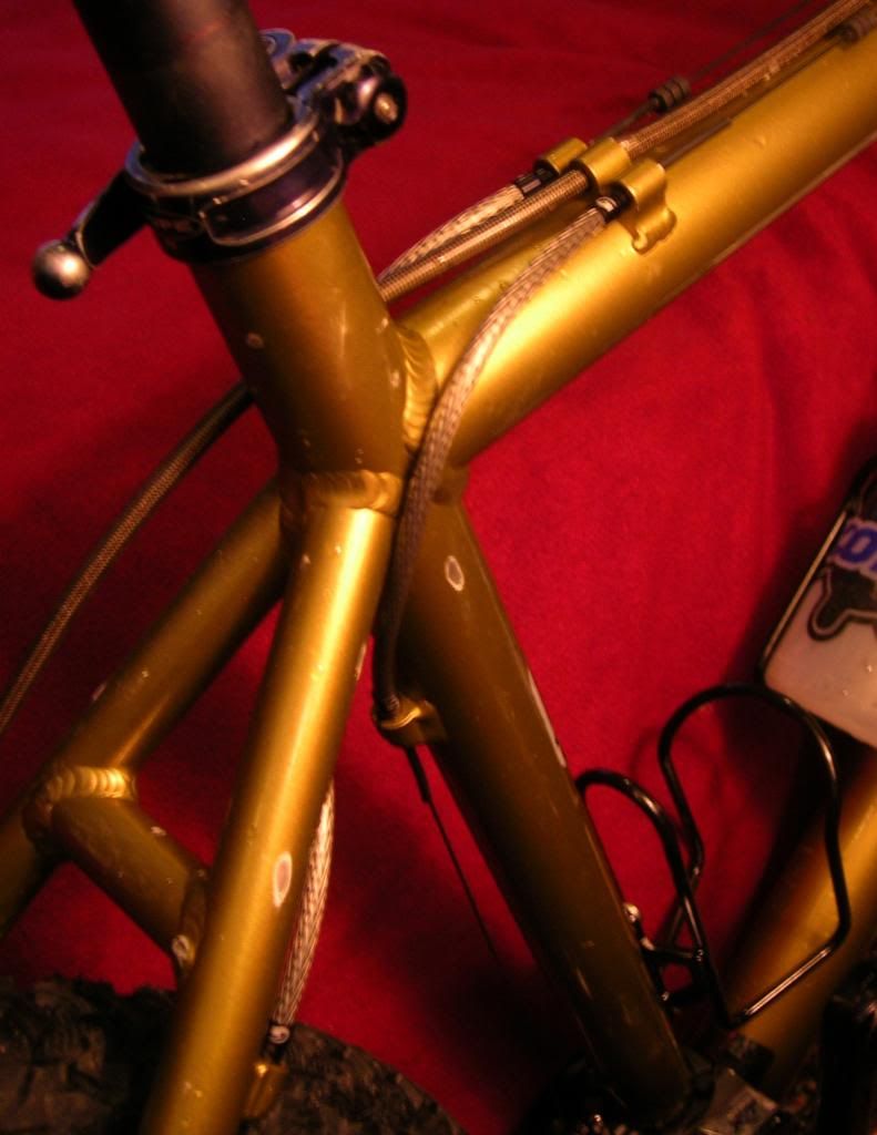

My 1998 Hei Hei is now set-up in a way that hadn’t occurred to me before, with the Rear Mech middle section following a seemingly natural route. Perhaps this is the way to go with 3 cable Top Tube routing.

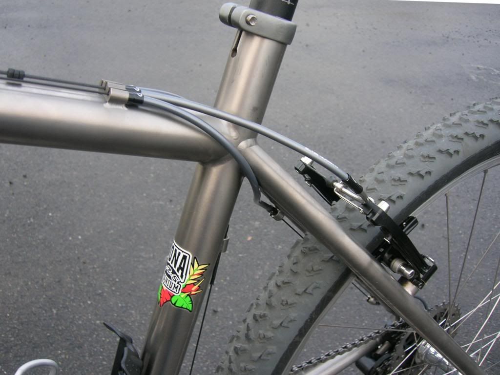

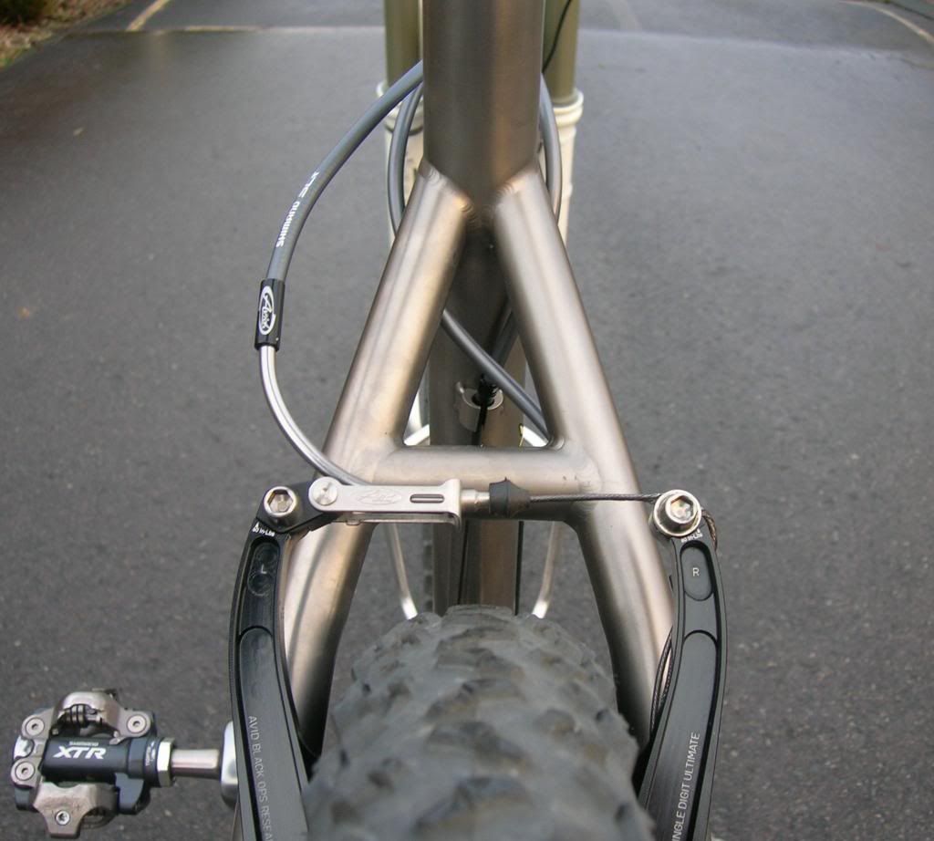

I managed to re-route my rather tatty 2001 Pahoehoe yesterday; once again taking the Rear Mech from the left hand stop and running under the Seat Stays. You can see by the wear on the paint how the previous owner had run the cables in a more conventional route over the top of the stay around the left hand side of the Seat Tube.

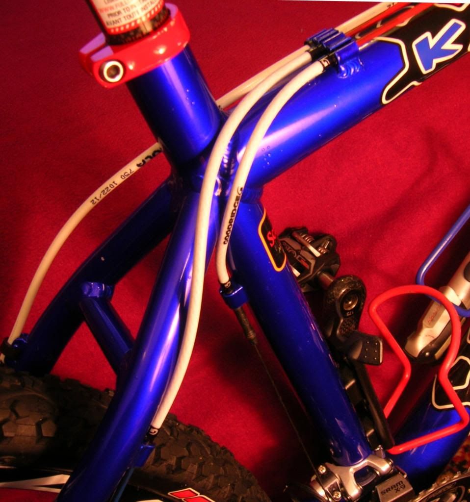

By 2003 however, Kona had decided to change the layout and dedicated the left hand stop for the hydraulic rear brake hose.

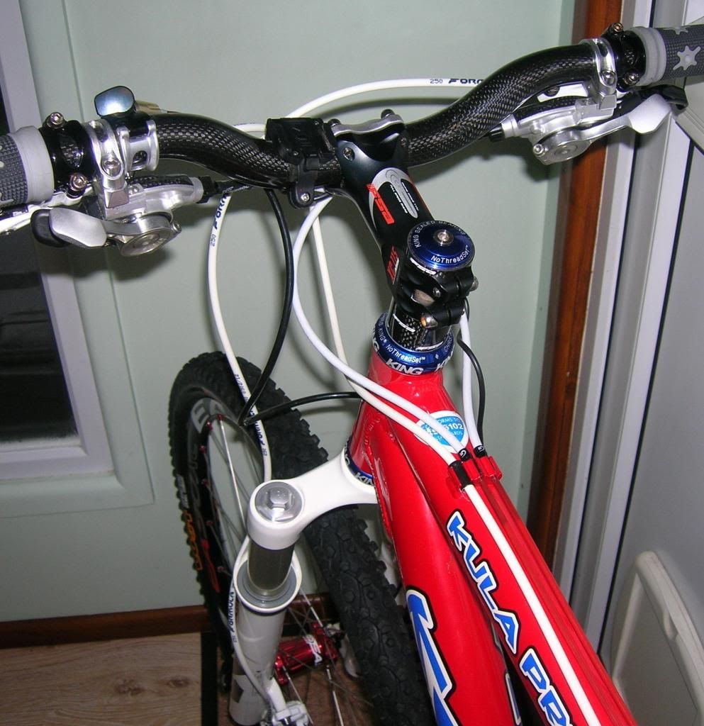

On my 2003 Kula Primo, you can see that the gear cables avoid touching the Headtube. I would imagine it would be rather tricky to route the rear brake hose around the right hand side of the Headtube, with a view to avoiding rubbing on the paint – as was the point raised in Anthony’s post.
Having said that, I do seem to have managed to put a sort of spiral loop into the rear hose around the left hand side of the Headtube, resulting in very little contact with the paint.

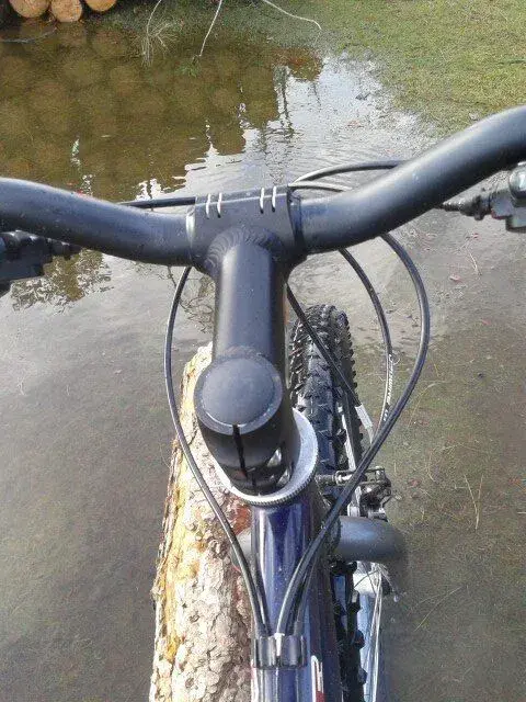

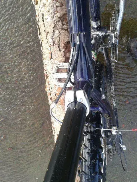

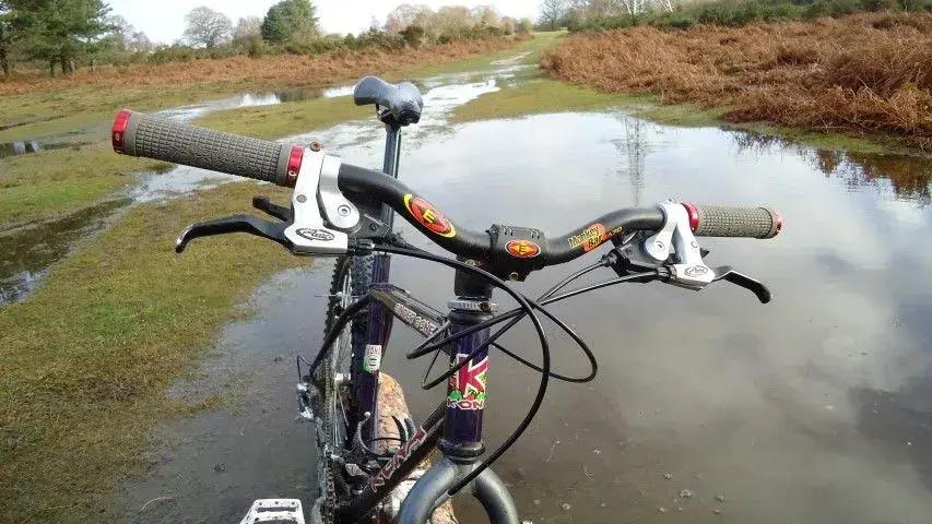

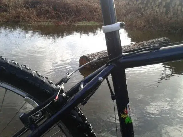

Thanks for the replies. I now have recabled and I'm very happy with the end result visually and mechanically. Still doesn't look as nice as a Hei Hei though :cry:
