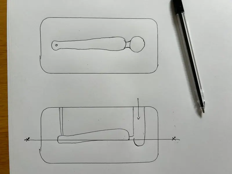

It's not moulded.. how would you get the molten metal into the cavity of a closed mould?.. the crank doesn't have a flat back, therefore it would need to be made in 2x halves to create the shape..
You need a runner system.. like this^
You would pour your molten aluminium into the feeder head and it would flow into the casting via the ingate.. the thickest part of the casting will be the last to cool (modulus) so as that section contracts, there is enough metal in the head to feed the casting, giving you a sound crank without cracks..
Once cooled the flashing around the casting is fettled away, the heads are cut off to be melted down / used again.. the riser on the other end is just to keep an open flow / no back pressure.. if you can't see evidence of any runner system but you can see flashing it isn't a casting.. how would you get the metal into the mould cavity othrwise?
