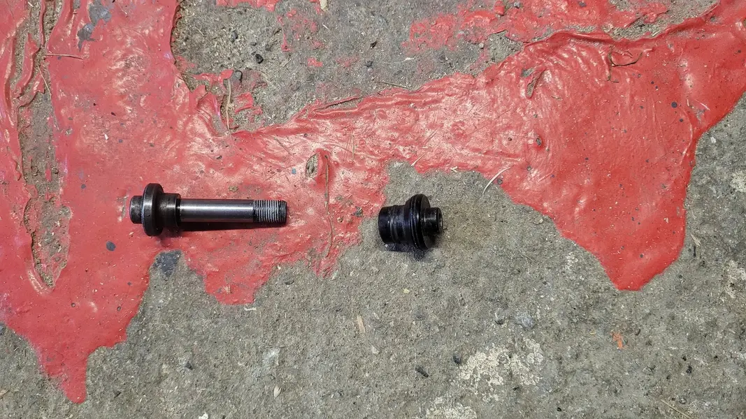

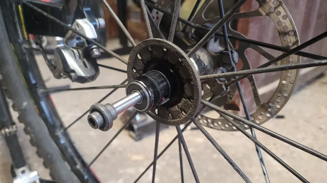

Ok cool thanks for the heads up.. Looks like Im screwed then.. I only seem to have 8mm bearing behind the cassette when I take it off.. Inside was an 8mm half axle to keep on the cassette threaded into the hub itself, and a nub on the other side.. Dont you just love how somthing so simple now costs you a complete new wheel.. :mad:

Its confusing me.. It actually looks like a 12mm axle would fit through the hub if I was able to remove the bearing and whatever is inside that the 8mm axle threads into.. Whether or not I could find somthing then to make all that work is another story..
