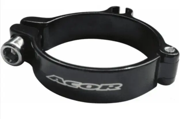

As noted above, a clamp-on cable stop is one option, and it's probably the best option - certainly the easiest option.
A more radical option is shown in this thread: http://www.retrobike.co.uk/forum/viewto ... p;t=411129. I've never tried sawing one of those brazed on pipes, and I wouldn't do, but apparently the brakes worked well.

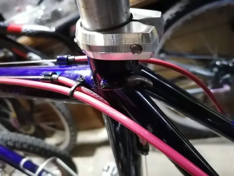

I have this on my Fisher. Theres no decent photo but you see how I got around 'The Noodle'
not the most elegant solution but certainly practical
file.php
