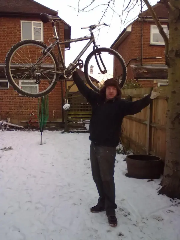

SOLVED 1 ISSUE F@kD ANOTHER
the headset shims sound greaT , in the end i actually found a solution, which is to use the 1" as is and replace the little (very technical) ball bearings with a load, think about 12 or so of larger ball bearings 1/4" ones,
unfortunately having fixed the stem in,hooray! found the bloody stem stuck, it did move a bit and drilled out the thing that draws the stem tight, got frustrated used a bigger and bigger hammer , then a sledgehammer and have now funked them completely.....
but did solve the headset thing and am getting a donor bike on friday!
bearings look like they work but didn't
no they didn't had to cobble together the cups! but in the end it did work!
