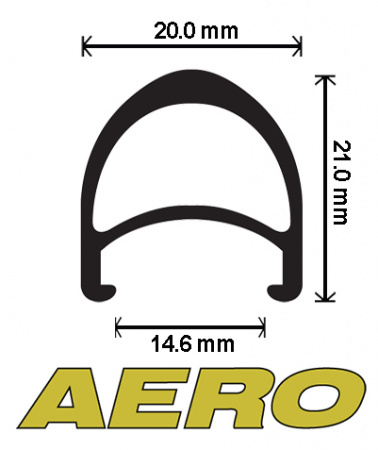

have you looked at the Velocity Aero 27"
comes in (stated) existing drillings of 32, 36 and the magical 40 holes.
they also (stated) offer the Synergy profile in a 27" with drillings of 32, 40 and 48 holes
