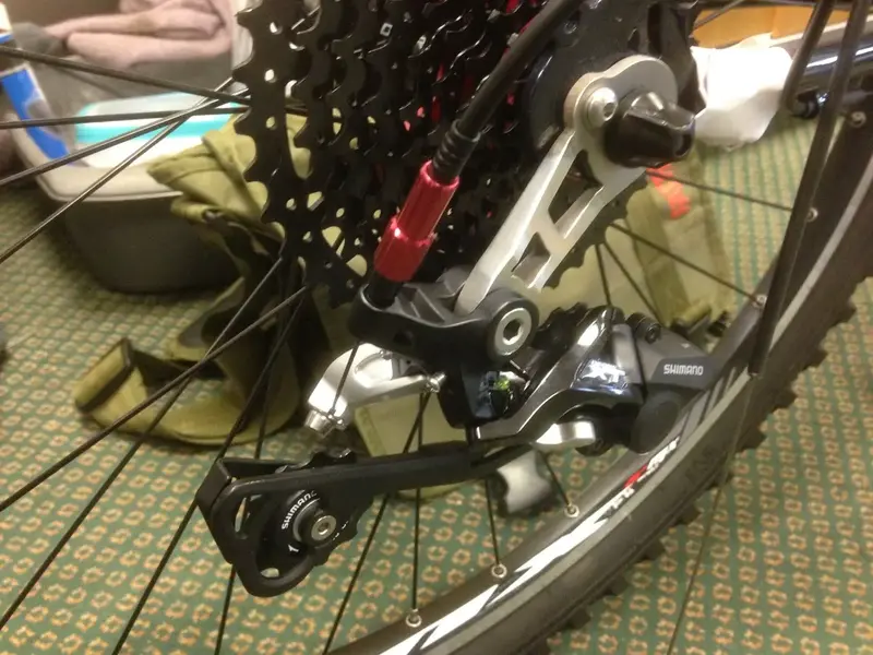

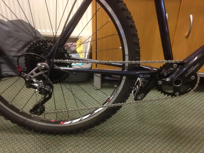

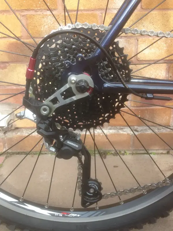

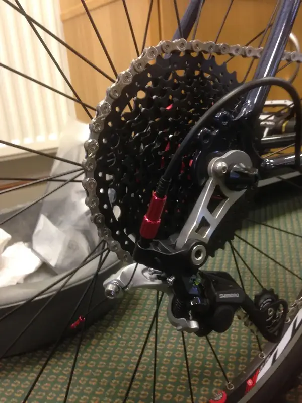

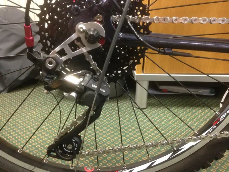

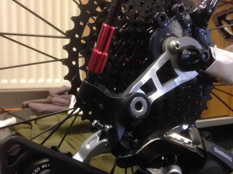

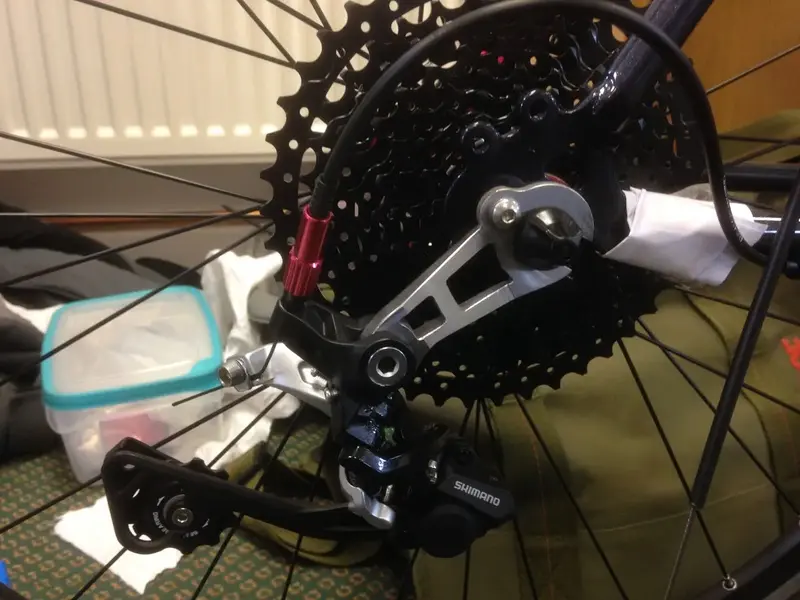

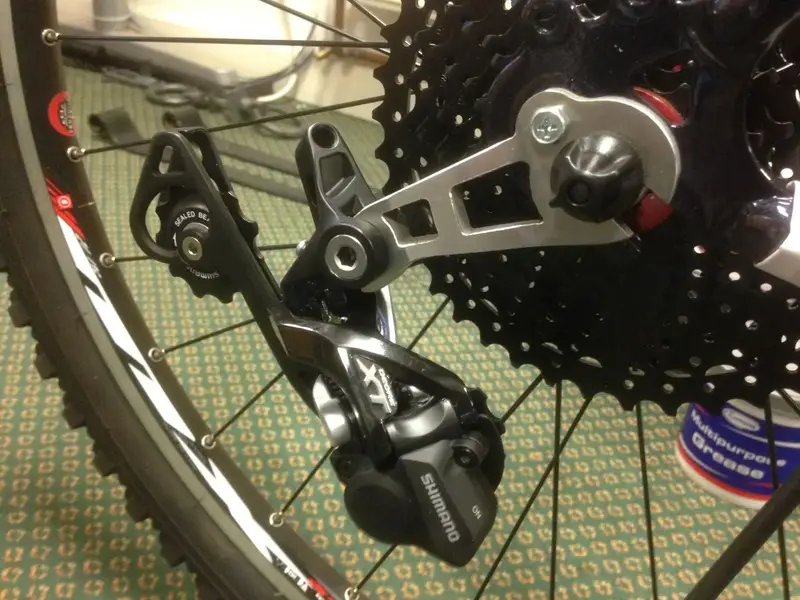

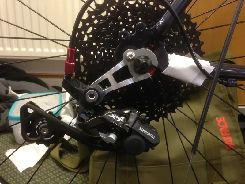

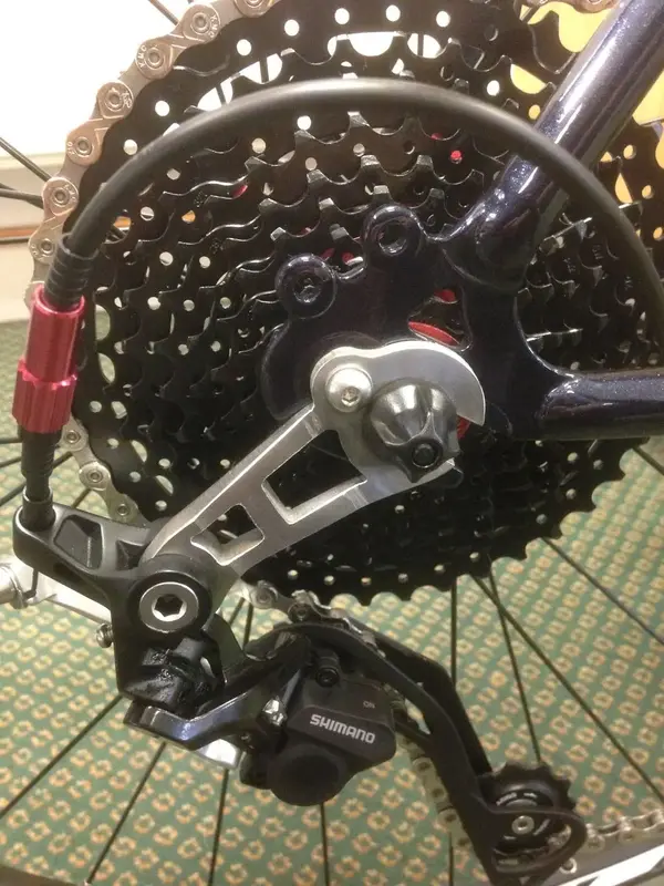

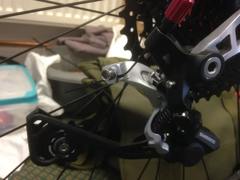

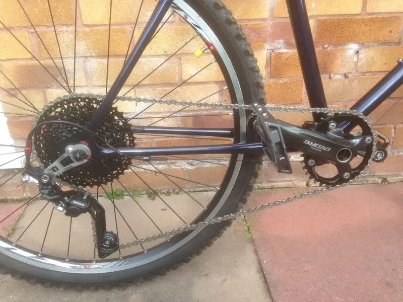

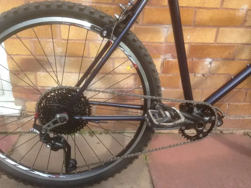

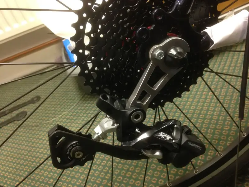

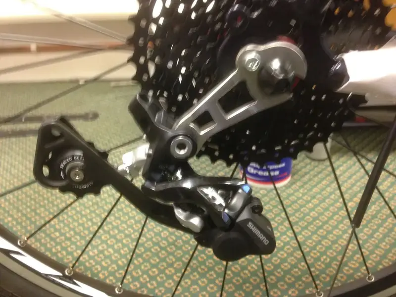

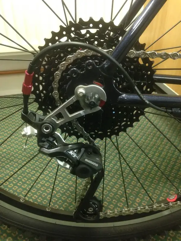

Next came fitting the derailleur and its initial set up involving setting up both stop / travel limit screws and setting the B screw to roughly the correct position.  These three tasks were easily achieved with plenty of tolerance still present for future adjustments if required.

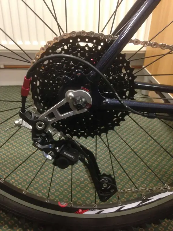

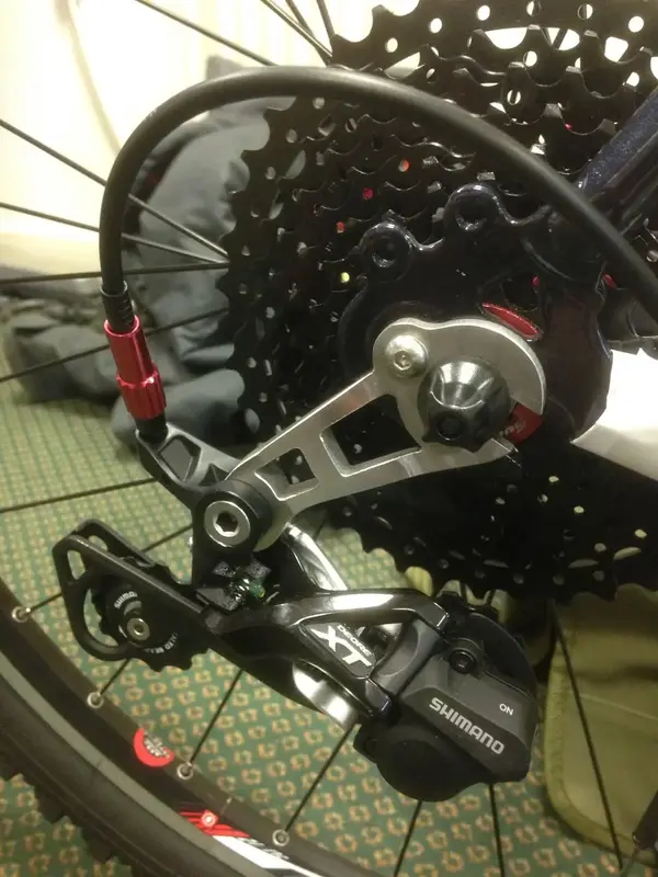

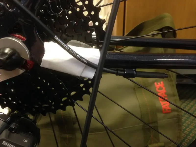

Then I measured and cut back the gear outer housing allowing for the in line adjuster that I want to fit. I feel that this in line adjuster will present great advantages at the back of the bike when it comes to fine tuning especially as mine is not a standard set up.

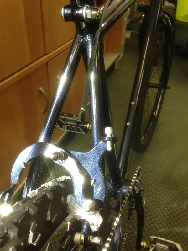

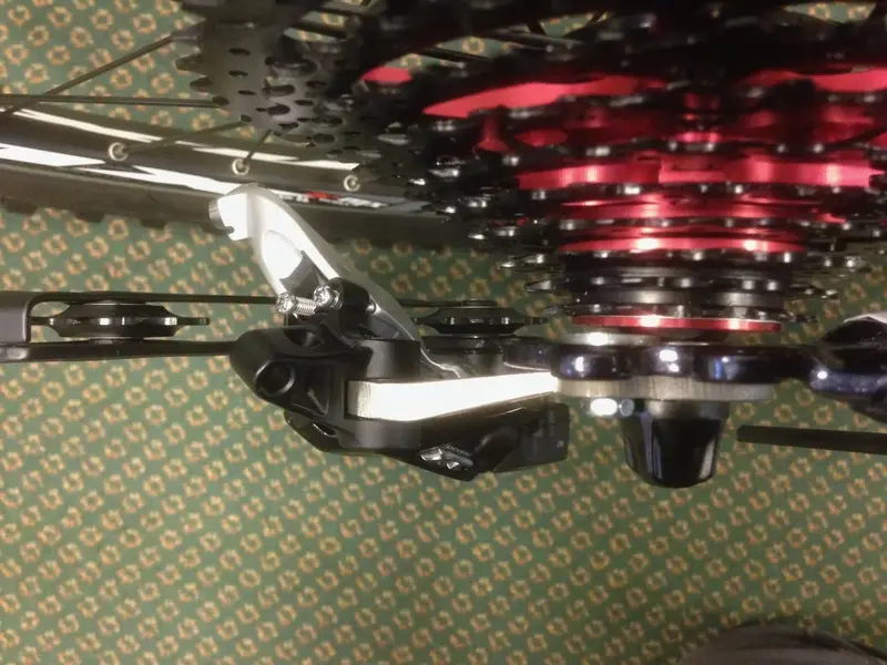

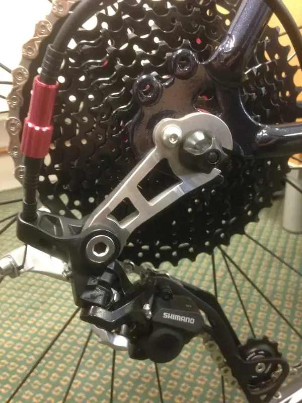

I also fitted my new stainless bolt fitting in place of the one that came with the original aftermarket traditional hanger. This mushroom head bolt has a hex head fastener and I have cut it down to length to match the other so the fit is nice and tight without extending out of the back of the dropout.
Some photos below...
