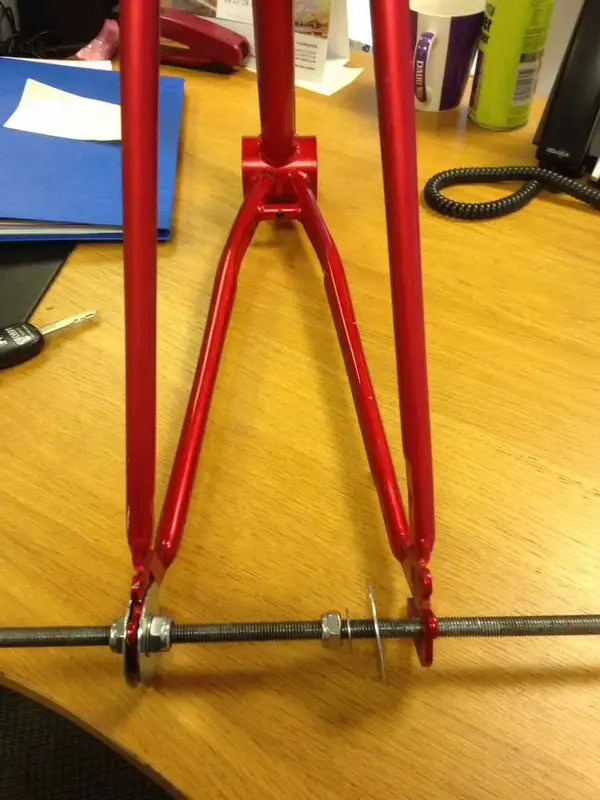

First job I tackled was modifying the rear drop out spacing. The frame currently had spacing of 126mm between the rear drop outs and this matches back to what I have read online for a 2x5 MTB. As I plan to fit a 10 speed rear cassette and wheel I had to change the spacing to 136mm, 5mm increase each side. At the same time I straightened out the drop outs as they were originally not parallel with each other and where 3mm out of square.
To reset the frame I made up my own tool using some M10 penny washers, threaded bar and nylock nuts.
It took in the end around 5 hours of careful work to adjust so the dropouts are equal distance from the main frame and exactly 136mm apart from other. However really pleased with the results. Next to order the rear wheel and 10 speed cassette.

Very interesting .. and aren't you creative. :idea: I'm keen to see how this project comes together for you ...
you'll need some DMR wonder cups or similar to fit an MTB bottom bracket to that old-school BMX type shell.
I'd recommend using some long-drop dual pivot road calipers instead of the pressed steel affairs that are fitted too

Thanks for looking and your feedback. I noticed at the weekend is was going to need some sort of adaptor to convert the bottom bracket and have purchased a Truvativ Bottom Bracket BMX American-Euro convertor off Amazon.
I will look in to the long drop dual pivot callipers you mention, thanks for the tip!
