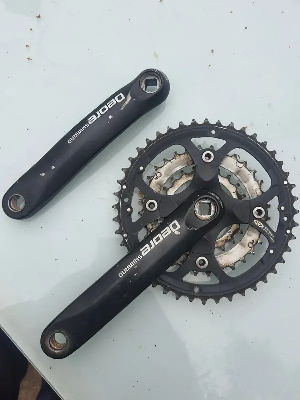

If it's of any use I have a mega 9 Deore square taper crankset I was going to list on Facebook later. Came on my Haro Extreme but is far too modern for that so I wont be using it. Yours for a tenner plus postage if it helps you out. Let me know if its of interest and I can always pop up a couple of pictures for you.
Here you go. Arms are 175mm. I took them off a few days ago in preparation for sorting out my Haro, it should be all M900 on there. I guess these may have been cheaper for the previous owner than just buying new rings if they had worn the originals out. Threads and tapers all seem good.
