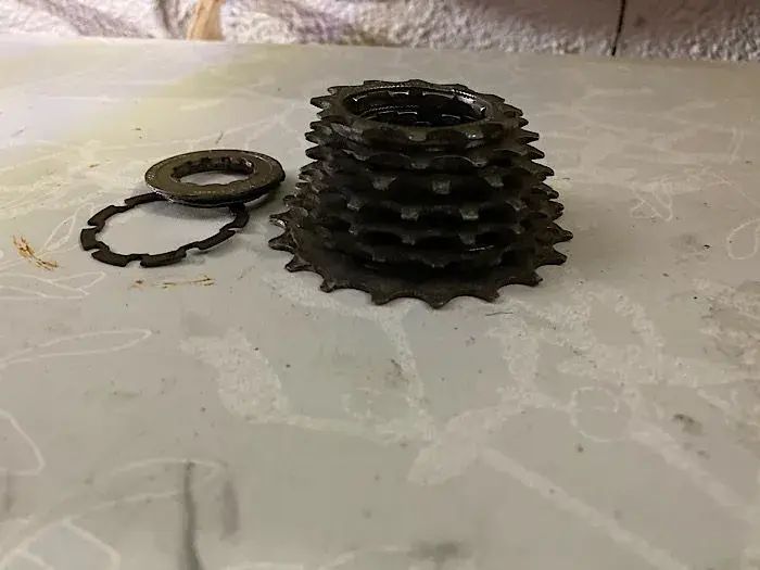

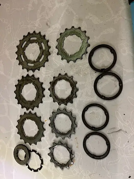

Here it is in all its oily glory, like I said yours for postage if you want it

The other solution is to crack open 8 or 9 speed cassettes - reuse the 7 speed spacers and harvest the sprockets you need. The sprockets are all the same thickness.
Similar thickness, but not the same! see Sheldon Brown spacing data.

fastpedaller":3n5wpnxt said:
https://www.sheldonbrown.com/cribsheet-spacing.html
7 speed is 1.8mm for 7 and 8s, 1.78mm for 9s.
10 speed is 1.6mm
As 7s uses plastic spacers which compress with tightening then its all within tolerances. The total of 0.12mm difference for the stack height using 9 speed sprockets is not detectable.
OK, to be completely pedantic it's not the same thicknes for 9 speed, but exactly how many microns tolerance do you need?
hamster":dj6tucvf said:
10 speed is 1.6mm
OK, to be completely pedantic it's not the same thickness for 9 speed, but exactly how many microns tolerance do you need?
Enough for a centeron guide pully to not max out, (but hence the name of Shimano's top pulley) Not used in 10sp + setups ??
