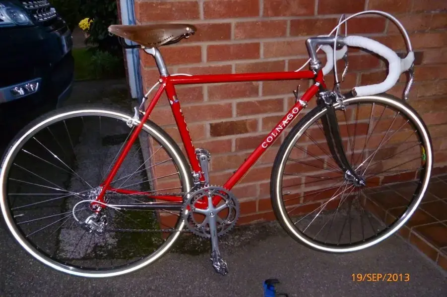

Can anybody confirm my frame is Italian threads on the BB as I'll buy a matching Chorus one too ??
It's almost certainly Italian, but to be sure just check the BB that is currently installed, or measure the bb shell width, 70mm is Italian.
Be sure you are measuring just the shell and not the lip of the bottom bracket currently installed. There were some Italian BBs that measured 73mm but those were almost all in the 60s and earlier...
Bike now finished
Only thing left in the end was the BB so I had a new one fitted by Ride of Coventry, Excellent service, really friendly and helpful. Campag Chorus, Italian thread, right size too. really pleased.
Have ridden approx 50 miles in 2-3 rides and its great, see attached
Nice frame but this mix of '80s and '90s parts looks somewhat strange.
What is totally out of place is the saddle.
