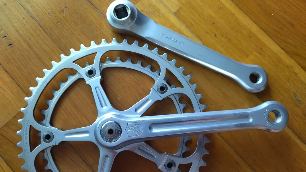

'77 Crankset is here, but chainrings are newer (see "BREV" instead of "PATENT"). Anyone interested to flip these let me know please ;)

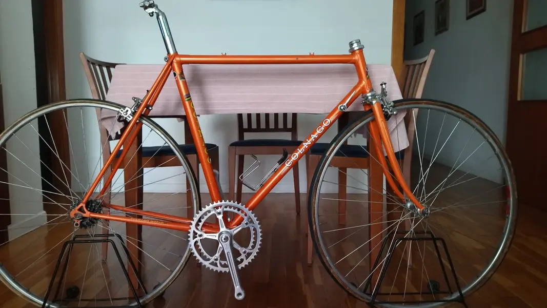

Just an update of current build, with the Titanium OMAS BB and '77 crankset. Still looking for a period correct nisi wheelset .....
Just received a nice wheelset from Italy for the build . A pair of Nisi Countach Mercurio d'Oro 1977 rims on Super Record hubs, and 126mm spaced. I will sell the 120mm spaced ones I bought by mistake;( if anyone interested.
I have also a 14-32 Regina Synchro 7 speed freewheel for the climbs and not sure to make myself a modified record cage or just look for a period correct Suntour rear derailleur that copes with that. Tempted also to get a 14-34 freewheel....
Are the hubs truly Super Record with Ti axle? They were made for a very short period of time ('73-'75?) due to cracking; I assume due to an improper alloy and/or poor engineering regarding the stress they would be subjected to. Hubs for later SR gruppos were the Record hubs with steel axles.
I have a bunch of Colnago bikes/frames. I think your frame is older than '78 given that there is no "COLNAGO" engraved on the stay caps. The exposed nutted brake mounts are definitely a sign of the earlier builds, as well as the blank fluted stay caps. Since Colnago would make changes during a model year it is hard to date, but I would go no earlier than 1976 and no later than 1978; but I believe the '77s and newer all had the engraved stay caps. I think the '75 and earlier crowns only had the "clubs" panto, and in either late '75 (frames for '76 model year) or by '76 the crowns had the "clubs" and "COLNAGO" pantos. The Molteni orange may have also been offered in specific years, but you could pretty much order any color of choice, chrome, and braze-ons as my friend did when in Italy so some features cannot help to further clarify its year (his was a '79 frame without any braze-ons except the BB topside cable guide channels). I have no idea as to the decal difference, but I would agree that they would have matched colorwise. You might want to use a magnifying glass to determine which decal most matches the patina of the paint (marks from polishing/cleaning), but I tend to think that the seat tube decal is correct (although it still may have been replaced). The other feature that pretty much puts it at 1977 or later is the Nuovo Record rear drop-out (indicated by threaded mounting holes) for the Campy portacatena system which was introduced circa '77-'78 in a Campy catalog supplement and I think was dropped by '82 (2 hole drilled drop-out not shown in '82 catalog even though the actual 2 bolt chain holder that mounts on it was still available). I doubt that you would find that feature on a '76 or earlier frame (except test frames, etc.), but those drilled drop-outs were still being used by builders into the early-mid '80s due to using up old stock. Another feature is the chain stay bridge which started as a small hollow tube and then was changed to a solid (I think) hourglass shaped piece. I know the tube style bridge was at least used up to model year (frames made in late '79 to mid '80) 1980, changed circa late '80-'81.
