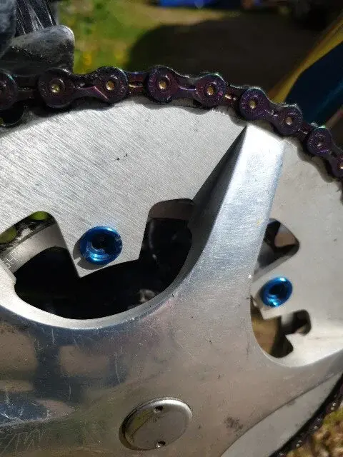

Did you drill the outer chainring to fit the Starfish bolt pattern?
It suddenly struck me that as a retailer, I could avail myself of a staff purchase price of a Supacaz bottle cage
 - because unlike 99.9% of the bike stuff i order, its actually for me!
The outer ring was a narrow bmx item sold with drilling for 130 and 110.
The mavic chainset had a spacer holding off the inner ring with the chainring bolts threaded into a blind socket in the back of the arm.
I used these spacers to hold a 34 tooth ring off the 110 holes, with single chainring bolts flush holding the outer onto the spider
One day I will polish the outer ring.
Shifting is pretty good with the ergos, although the f.mech clacks on the crank arm if you don't trim after a change onto the outer.
