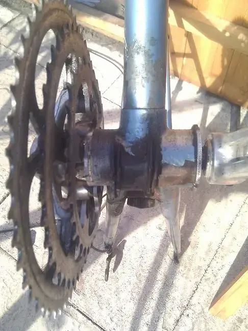

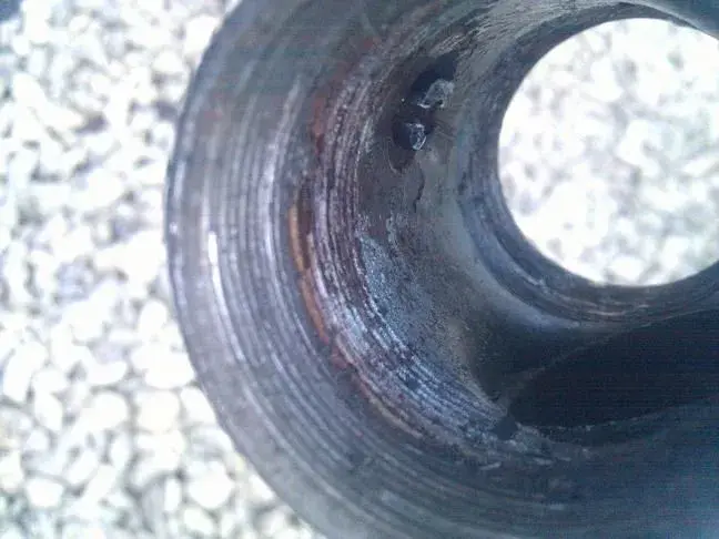

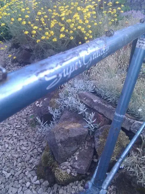

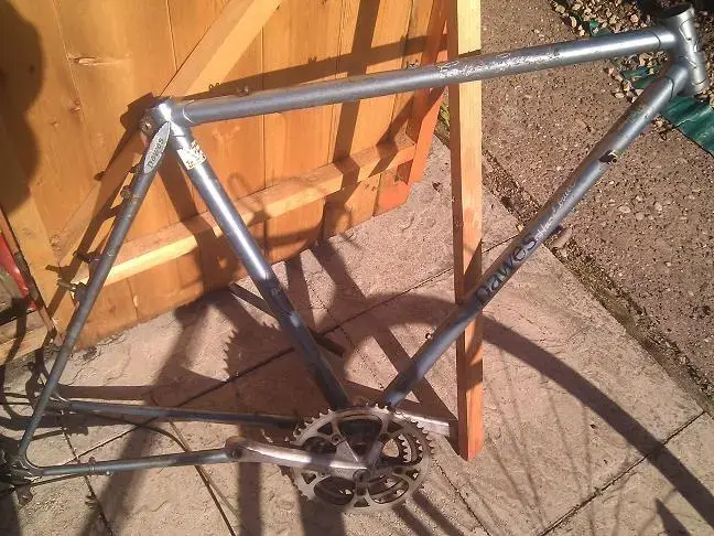

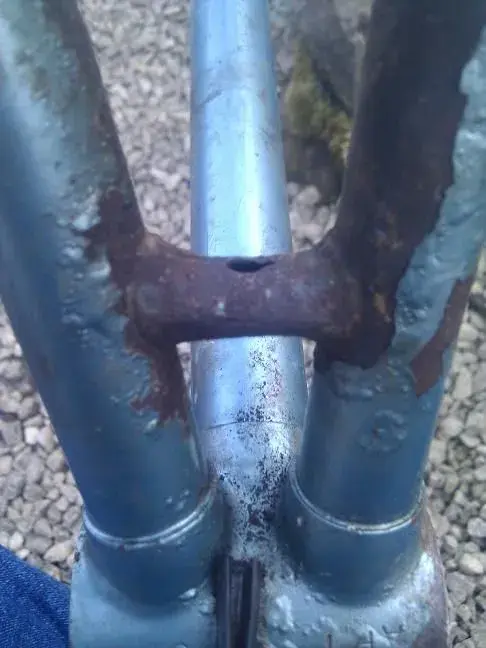

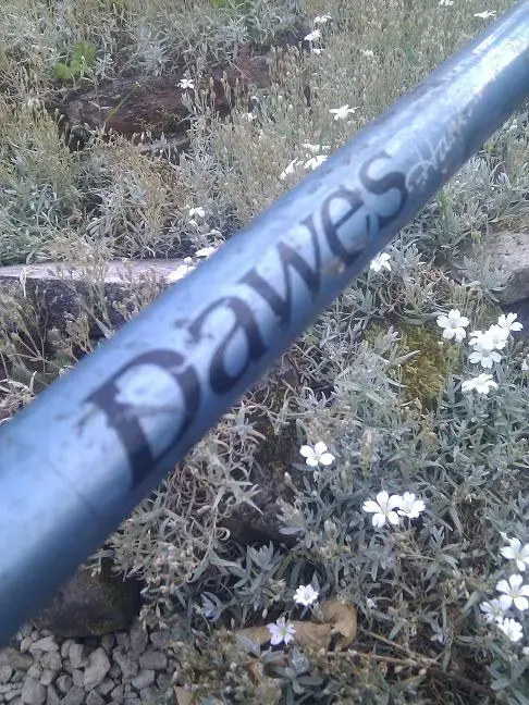

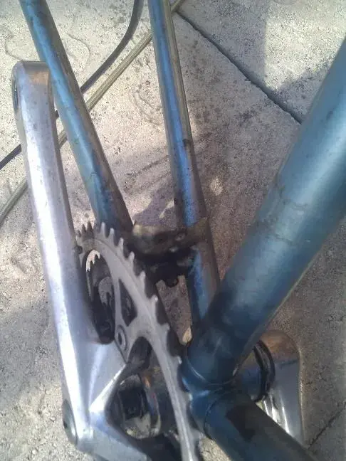

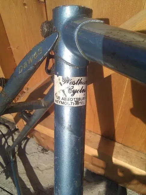

However, the bridge between the chain stays seems to be the worst affected by rust. I've attached a couple of pics, if anybody could advise what they think of the condition of it, be much appreciated.

Most of that rust looks worse than it is. I'm seeing nice a cast BB shell, the threads will be fine after running a BB tap through them before building up.
The bridge does not look so clever. If I'm not mistaken there is a bit more rusting around the hole, which may spell trouble.
Frankly nothing looks terminal so far. I'd check the frame carefully after blasting for holes. Frames rust from the inside out generally.
