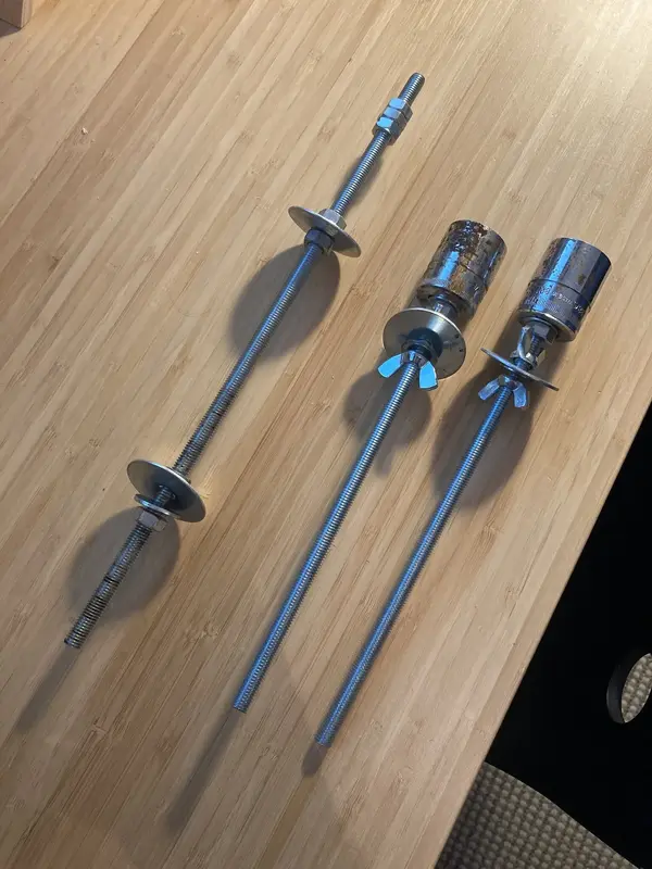

Hey Matt. I’ve done this using the threaded rod-washer-bolt approach.
The first ‘tool’ in the picture shows that, and you ‘unwind’ the nuts from the inside to out and the metal washers sit against the dropouts. I wound them out more that 130mm as the frame tends to set back after you untension the nuts.
Then I checked the dropouts alignment using the home made, er, alignment tools. Much cheaper than a Park Tool and just as effective.
