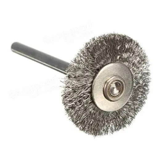

I have the taps available, but you could try a steel brush like this:
mounted onto a power drill to clear the paint.

Ahh nice one fellas.
Danson67. I actually have a smaller version of that fir the dremmel .. will work a treat 8)
