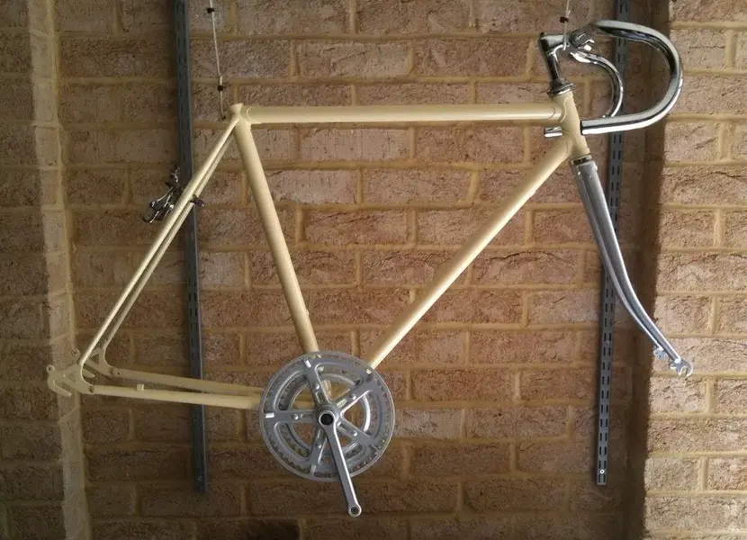

I've just started on a similar project....I've found the best way so far for parts is either some silicon spray and wire wool, and on the frame I used a rotary wire wheel in an electric drill! (steel frame that is....)
Part way through the rebuild now....don't think it looks too bad?
Mint !!!!!!!
Wow ! top job
