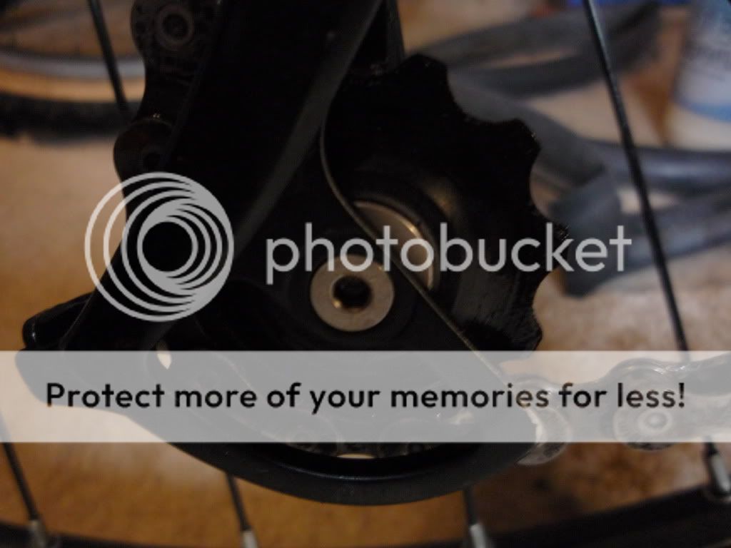

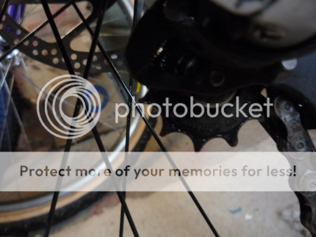

On another note, I left the house on the bike this morning and by the time I got to the end of the road the chain was jumping terribly. I think either the chain is catching on the hooks on the large ring and trying to shift up, or the freewheel is knackered. Does anyone have a idea of how I can confirm the source of the problem? I've put the bike in a stand and it all seems fine, the problem only surfaces under load.

2, :cry: Everything wears out and wears out together. You will need to replace the chain, rear cassette and worn front chainrings. Possibly the rear jockey wheels.
I've tried only doing half a job in the past but all that happens if you only replace some things is the old items make the new ones wear out twice as fast, Plus that if they work together at all.
Have a look at all 'cogs' and see if the have a pointed top or flat top. If the teth go to a point, BIN IT!

On the subject of your gears, by the looks of one of your jockey wheels, I'd say your cogs/gears/chainrings need replacing, as the teeth shouldn't be pointed.

If it only happens under load then it's a worn cassette, chain and possibly chainring. If it was as simple as adjustment then it would occur even in the stand with no pressure.
Check the tooth profile on the cassette and chainring, paying particular attention to the smaller cogs. If they look like shark's fins then it's time to replace the cassette, chain and chainring (bear in mind that they'll be at least 2 teeth per sprocket that have this profile anyway to aid shifting). If you just change one then the problem will still occur as the old chain wears in to the old cassette.

After a closer inspection this morning (I had to run home, dump the bike and grab my other one yesterday morn) I think there is something definately up with the whole drive chain. Time to strip it down and start replacing parts I reckon. It's been over 15 years since I built up a bike, so I might post up some pics of the parts in question once they're off the bike so as to get some thoughts.
