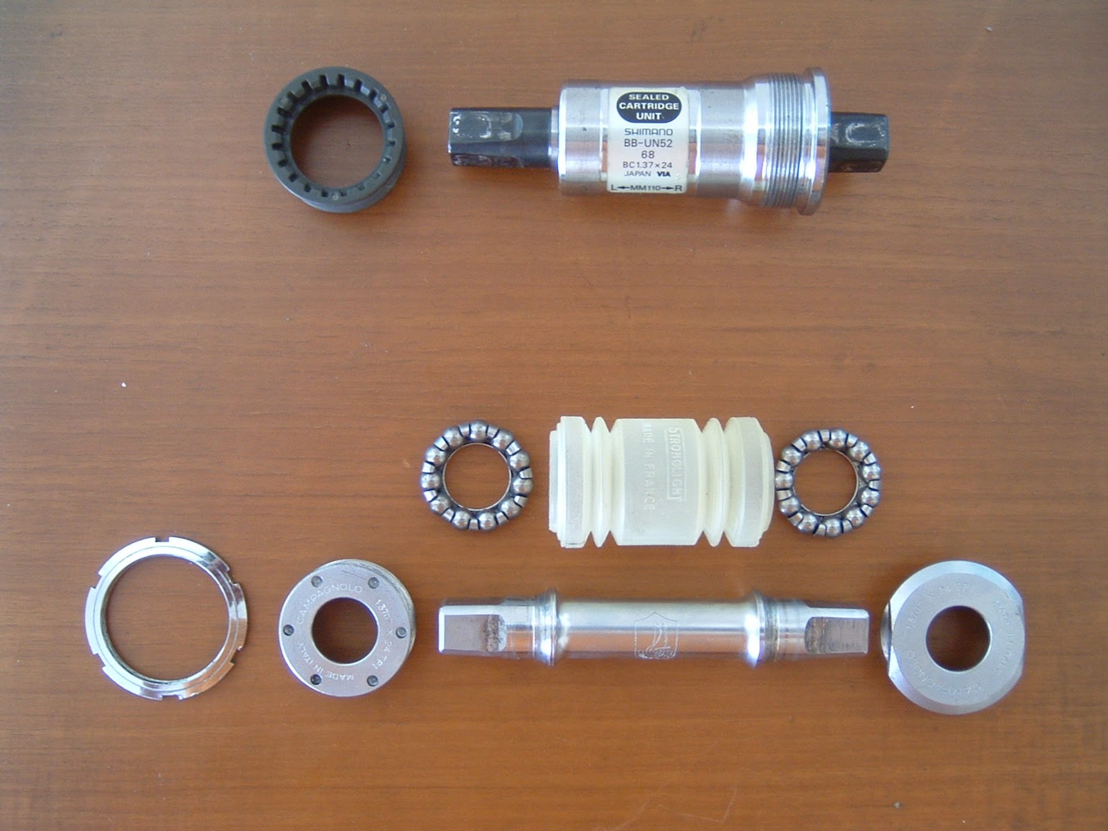

Get the local bike shop to remove the bottom bracket, regrease it and re-fit it, its very unlikely that there'll be much wrong with it anyway except maybe a bit of play. It should also be a Shimano cup & cone model too which means long life, easy servicing and better than a modern UN** sealed BB that dont seem to last that long.

What's the difference between a cup and cone and a sealed BB? IV got the BB out minus the drive side,just wanting a BB with minimal maintenance.

Cup & cone and sealed
Cup & cone can be easily serviced whereas sealed cannot and has to be binned when it goes wobbly
O.k so I have the cup and cone type just now minus the little plastic thing,it seems they're a bit cheaper than the sealed units.
Cartridge looks a lot heavier as well.
I take it it depends on the volume of riding how long a cartridge lasts for? Are they not better value over the long term?
Back in the days when I had one bicycle and do about 4 or 5,000 miles a year on it, I would replace the cup and cone BB at least once a year, I'd put a new one in, in the spring, it would be rough by the end of winter, despite cleaning it and repacking with fresh grease a couple of times. I'd usually put up with it until the better weather the next spring and then replace it. They weren't sealed and my then road bike had no mudguards so they'd get a fair bit of water in them and end up full of sludge like yours.
I don't do anywhere near that sort of mileage now, but have yet to wear out the UN55 or the UN72 I have in two of my bikes. The UN72 must have done close to 5,000 miles by now, it's been in there for years, and it's as smooth as the day I fitted it.
Whereas I've pulled out mint BBs from 30 - 40 year old bikes that have been in mint condition and worn out a UN52 in 6 months!
You picks what ya picks and live with it.
