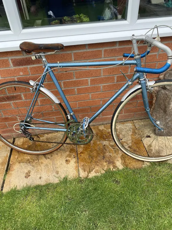

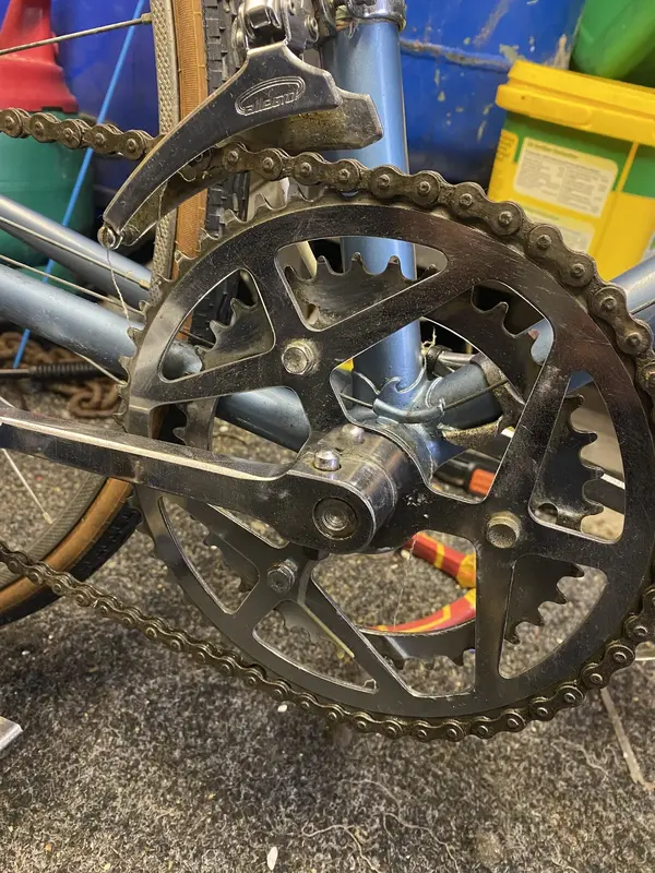

Claud butler age and model
Lilynobs

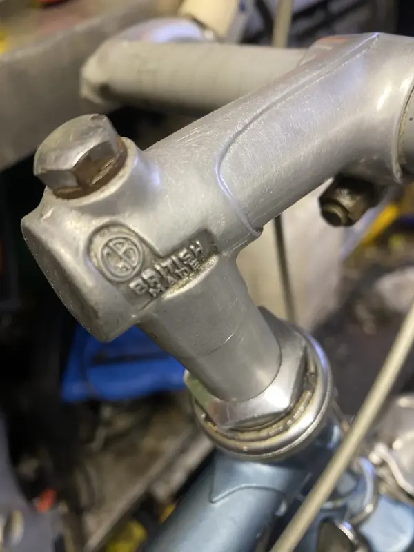

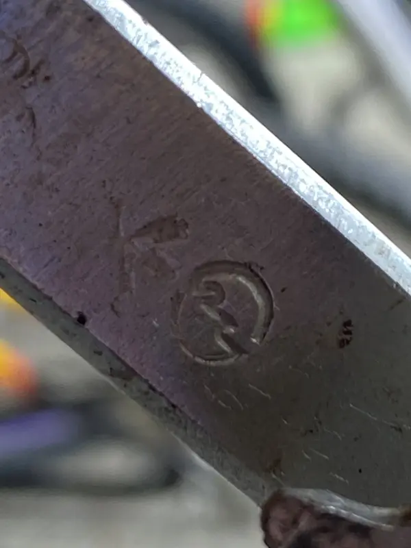

frame -
lug pattern NERVEX 48/161
bottom bracket shell NERVEX nozzle cut Ref. 161
dropouts appear they may be NERVEX Ref. 1010
pump pegs NERVEX Ref. 845
fittings -
headset appears Brampton; may be type with floating u-races which takes 1/8" ball

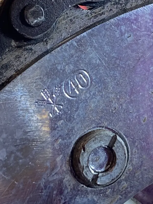

chainset Takagi, this firm, once independent, purchased by Shimano who kept name going

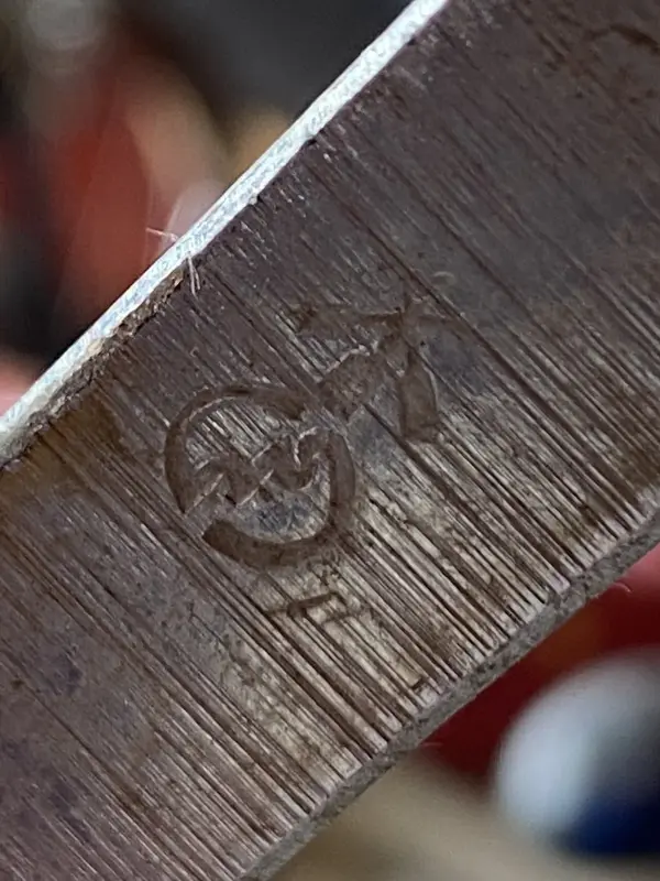

you should find markings on backside of crank arms and chainwheels
logo is three arrows

date -
appears close to transition time from Claud to Holdsworthy
tentatively leaning toward Holdsworthy
the forum's experts shall be able to state for sure
no shortage of information at the Kilgariff site:
https://nkilgariff.com/
