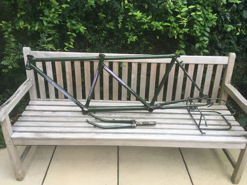

Time for a new build thread and new territory for me, never owned a tandem and just for double trouble, let’s start with the oldest bike I now have. What could possibly go wrong...

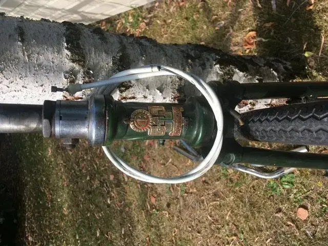

So, we have a (hence the thread title) as a most likely contender, a 1936 Silver Ace. Date stamps on the fork start 64, and with a read through Nikgraff’s CB resources and catalogues, plus and evening’s work on Flickr (where I found an almost duplicate 1938 example with tons of useful reference pics) I’m gong to call it in.

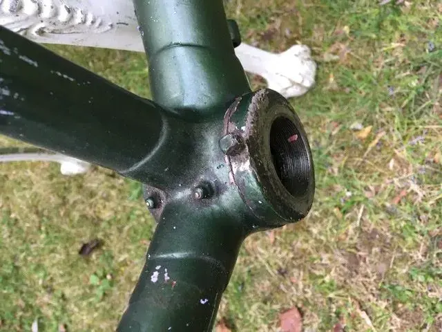

Came with everything show in the first pic. Nothing stuck or seized (except for two of the brass oil port screws, which I might need to drill out (but only if can source two more. Anyone?)
Hunting for frame stamps revealed the several colourful previous lives, back to what I think was the original red. All the decals are gone, no trace I can see so plan is to have it stripped and re-enamelled.

Right, enough waffle. Here’s some pictures.

Will fill the head tube holes, they were done really well and tapped so am wondering if it was refurbed with that around then.

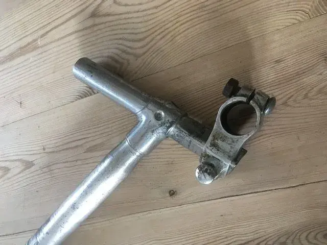

Bit of tidying up and tinfoiling, original (I think?) stem and Captain’s seatpost, both of which had been sprayed silver, which I guess helped arrest worse pitting.
Have filed the drilled badge holes with brass rivets and filed them smooth so hoping the paint will help with that bodge...
