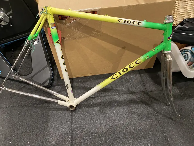

15F1FC8F-7B15-40DC-9390-F9890FA98D43.webp Hi
Just after some advice.
Picked this frame up to build up and need some help.
What would the seat post size be?
Bottom size and is is Italian thread?
Can you get the drop out screws..
Last one Any thoughts on value?
Unlikely to have anything other than an Italian thread BB - if it does I'd be suspicious as to the real identity of the frame. Dropout screws for an Italian frame of that era should be M3x0.5 thread.
cheers.. would you know the spec im just fitting a cartridge square taper
think it is legit from others ive seen has the correct brake bridge cutout in bb shell and other bits.
