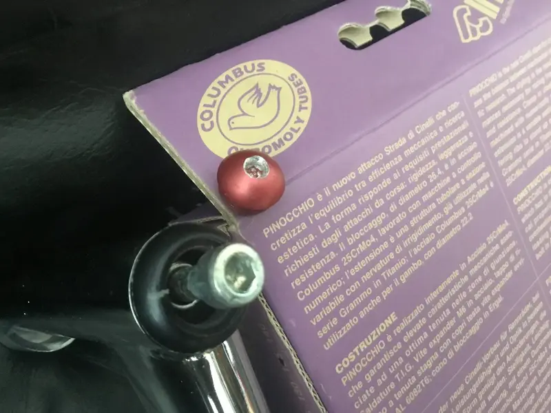

This really threw me with the Pinocchio stem too.
That red cap is just a ‘dust cover’. Like you I totally trashed it trying to tighten the damn thing up before it came off revealing the real bolt just underneath. As Cinelli don’t seem to sell a replacement cap there must be loads of those stems out there with ruined red caps or worse, (wrongly) discarded completely as a stem that is downright dangerous and unreliable. Such a shame, as, dust cap apart, it is absolutely gorgeous and solid as houses, once you figure it out.
Sorry just revisiting with a photo to illustrate because this was so incredibly annoying. I had two of these stems in the original packaging so I know Cinelli did not think to tell anyone that “although your new stem is made of the finest steel, what appears to be the bolt is in fact a dust cover for that bolt made of the softest anodised aluminium we could find. Although turning it will initially tighten the expander bolt, it will only tighten it so much before it starts to round off.” When I drilled the thing out and found out the truth I used quite a few choice words which may or may not have been Italian or Latin.
Be aware.

I also found this out the hard way. I actually picked up a second Pinocchio stem for 80kr (about £10) without the red dust cap. I asked the seller, but he didn't know - he bought it without, so I am guessing the original owner also mashed his top cap! You would think that they would mention it on the box (especially given how much nonsense they write on said box!).
Hopefully this thread will help some other poor souls, who want the shiniest stem out there!
