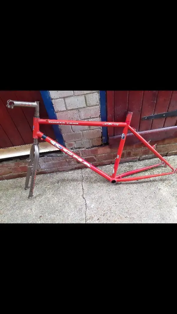

Started with a very rough frame/fork/stem combo from a user on the forum (cheers Paul) and a doner bike with an STX RC groupset I put this together
Appreciate it’s not period correct but I’m happy with it and it rides as well as I ever hoped so I’m more than happy. Might upgrade it as I go along.

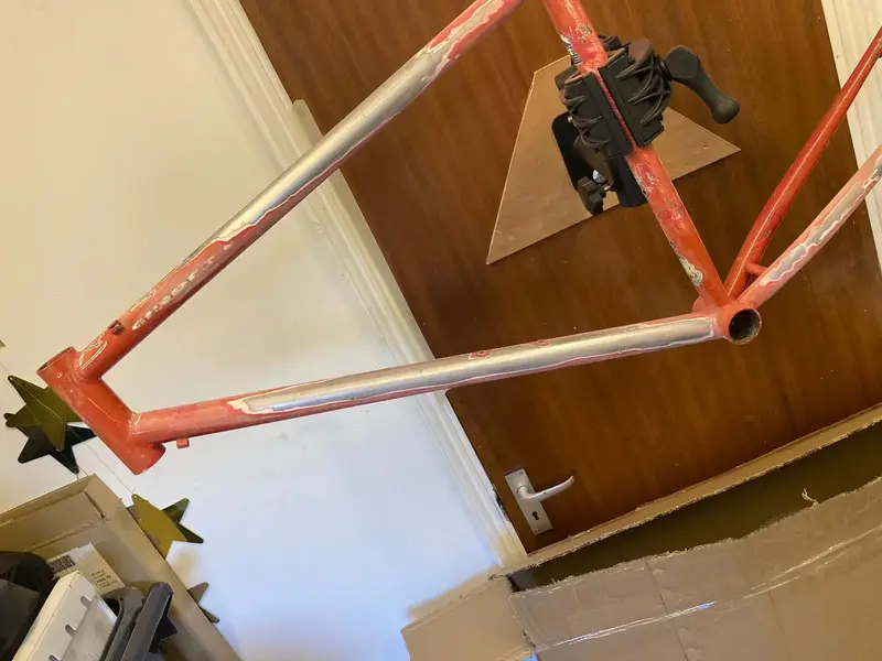

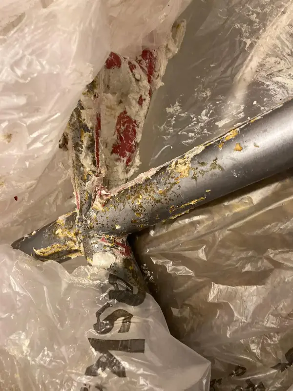

Some progress shots of the rather enjoyable process of stripping the old powder coat - combo of mechanical DA and industrial strength chemical paint stripper....

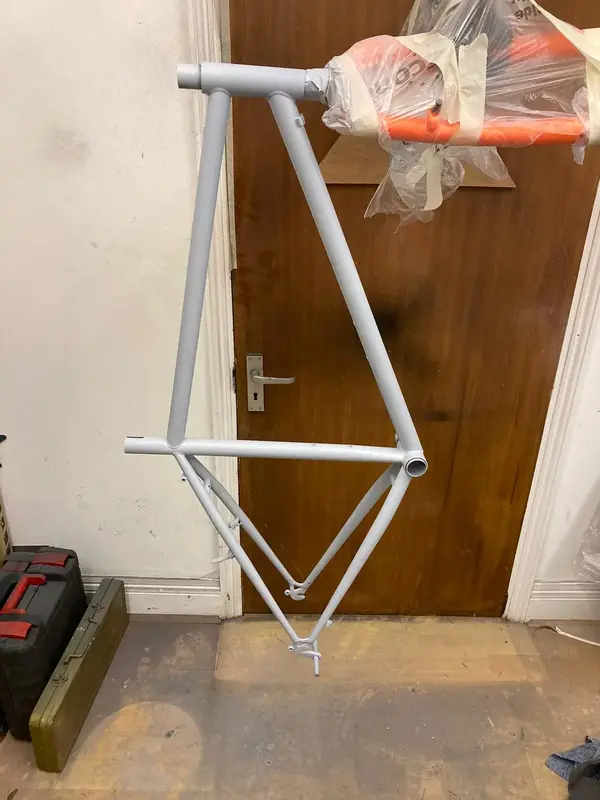

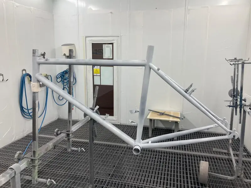

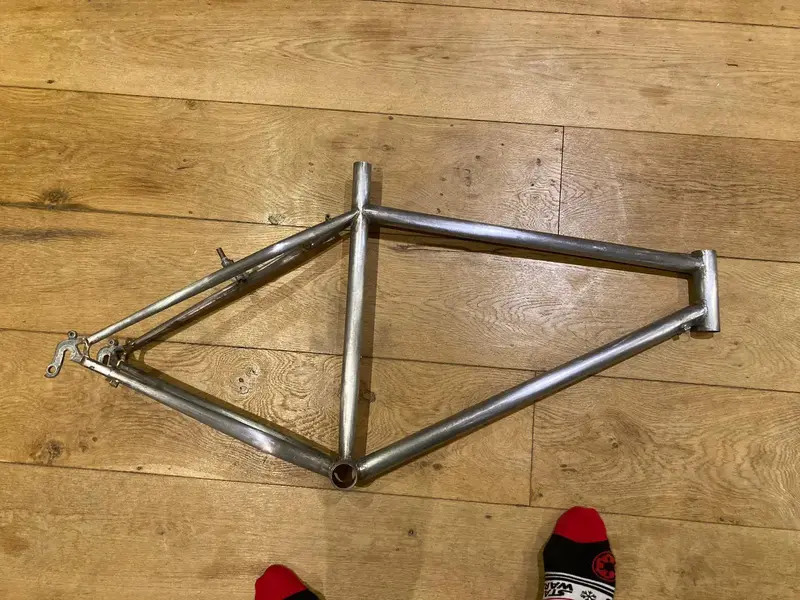

Finally stripped after several days of going at it then on with the etch primer and high build 2k....

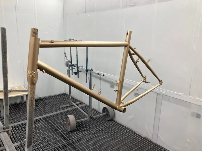

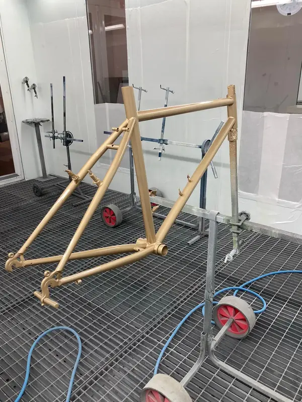

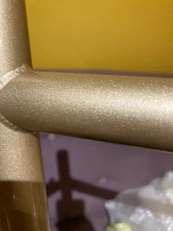

Then the basecoat and clear, then a flat down and on with some rather lovely Gil decals....

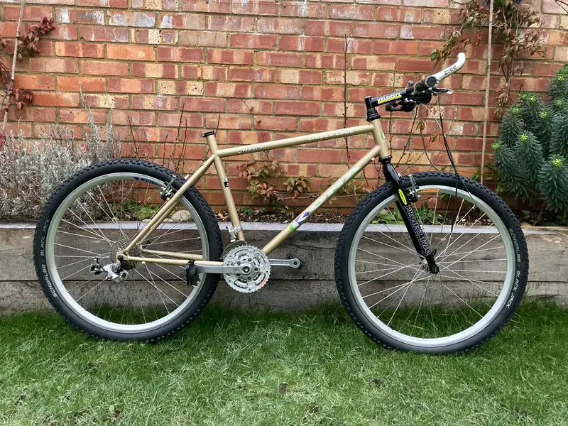

And finally the finished article. Apologies for the repeated posts as I don’t seem to be able to upload multiple pictures on one post....
That looks really sweet, colour is so much nice than that original red 100%
Well done 8)
