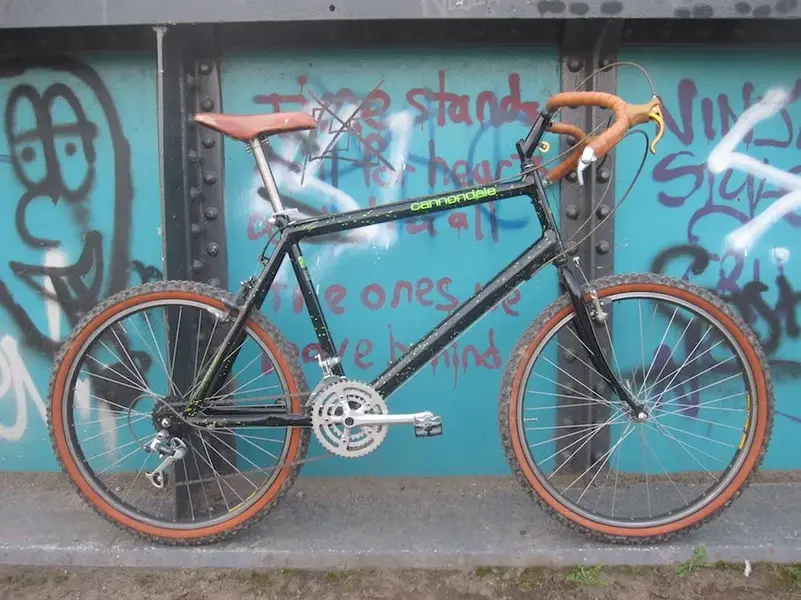

Something with a long head and/or slopey top tube tube keeps the aesthetics in check for larger frames eg. early 90's Cannondale/larger Kona...
