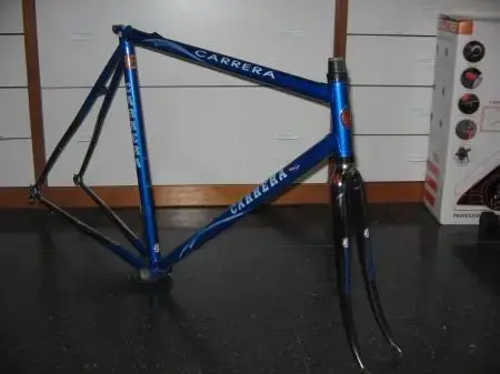

Thanks that sound like a plan, Is this a Cinelli bracket shell? it looks reinforced like a Cinelli.
What would be the equivalent of SLX in a modern tubeset? How about Thron? is that lighter than SLX?
