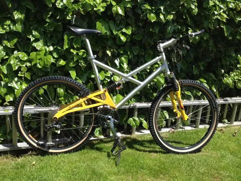

Agreed the kit looks good value for money...one question are they for a standard drill chuck or Dremel??
And I think mine will take more than 3 hours to do looking at the complexity of the swingarm!!!
