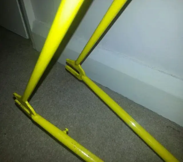

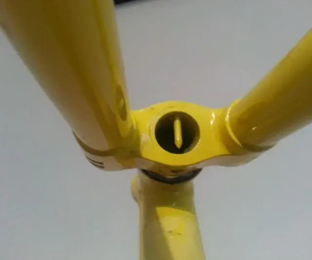

A few more photos…….
Got a nice rear end :D
But curiously it has a yellow nail in it ???
Any ideas about the nail would be greatly appreciated.
I've been looking at Chater and Harden components and I can see that this build may tax the old bank account faster than my wife's shoe habit :shock:.
I may have to sell some of the two wheeled treasure up in the loft :cry: or auction off the children and yellow dog. Hmmm that's a thought, It's a nice dog…….

Re: Ekla Fork Crown ?
Probably built with skill and no jigs. Joints were drilled and pinned to hold the position before brazing. Before TI takeover, Raleigh Nottingham frames (many millions) were drilled and pinned. Minor corrections to frame alignment due to joi nt cooling would be corrected by hand builders as they proceeded, Raleigh did minor corrections when the frame was complete.
Commonly pins were mild steel nails, but could be bought specially.
You will see some more inside the bottom bracket.
Keith

Thanks for the information on the nail. I guess they were an abundant supply of cheap machine made nails/pins that were easy to braze, so why pay for special pins.
