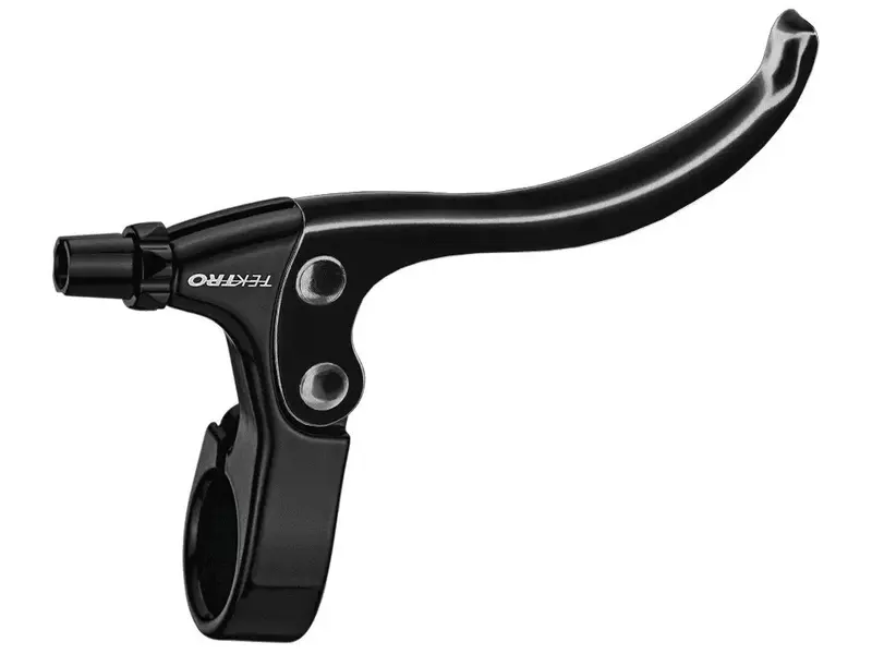

Hi I have a Dave Marsh 700c road bike built 1980 with downtube shifters and Weinmann side pull brakes. Levers are Exage.Following heart surgery I am finding bending over a problem and want to install some flat riser bars and bar ends. Can I still use my Exage brakes on the flat bars or will I need different levers? Colin Thank you for reading
I would change the brake levers. Makes for better ergonomy. Doesn't have to be expensive. I have these, got them for 22 euros (18 pounds):
