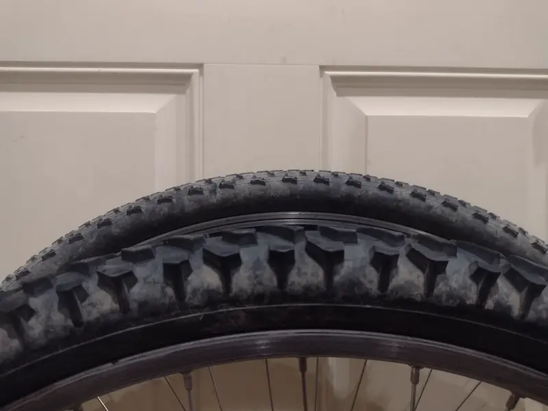

Cheers you have told me things there that never even entered my head I knew thinner tyres and rigid forks I keep seeing these 700 wheels the price etc and thinking wow if there were 26inch be 3x the price
Not to be contrary, maybe I'm missing something, but it sure does look like a difference to me.Disc allows us to swap wheel size.
but you can buy decent 26s used for peanuts because mtbers are clearing out their sheds.
As a rule price determines quality.
Beware cheap wheels.
27.5 is about a half inch larger in radius, so if you swap a 26x2.1 (around 52mm) for a 27.5x40, you'll get roughly the same o.d. and in turn the same bb height.
A 700 is an additional 3/4", so it would probably need to be super narrow to fit and not feel weird.
