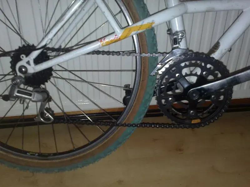

just swapped chains to a brand new but low quality z chain, problem is worse if anything, so gonna change the rings
hi ya big holes johnson, do you have soe 94 bcd rings for me then, whats your opinion on the cassette also, i can never tell if these things are worn
Your cassette looks a little worn especially on the smaller sprockets. When you can see burrs on the teeth it's usually an indicator of wear.
As for your chainrings, let's just say that my Dad has got better teeth than on those ones.
That outer also looks pretty well worn out. The middle looks okay but the inner looks a bit ropey too.
How wide is the chain you are using? That TAYA one almost looks like a 1/8th inch BMX chain rather than a 3/32th MTB one.
Charlieboy
Your 6,7 and 8 sprockets are quite worn - I wouldn't expect them to be smooth with a new chain. Your middle chainring is the main culprit though, that it quite badly worn. When you put load on it the chain simply ramps up the worn teeth and pops over the top.
