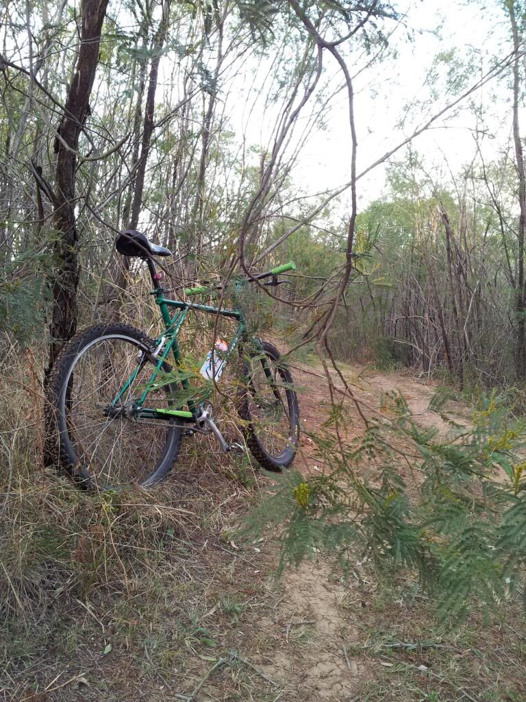

Certainly, here is an obscure bottom bracket view. It fits over the BB cup and hasn't budged.
Here it is cleverly hidden by green trees.
The only things I think to consider about ETR-B is if you don't have a lot of tyre clearance near the BB/chainstay junction.
My frame won't fit biggish tyres, so no problem for me. Living with puffier 2.4" on the rear might be different story.
You can get a longer axle on the ETR-B to give more adjustment of the jockey wheel outwards.
When in doubt, move things outboard and move the ETR-B arm upwards away from the tyre :wink:
It is bit little noisy but no more than a rear mech IMHO. Overall, I'm pretty happy with it. It is a neat solution.
