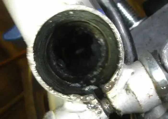

The seat post had been cut off and hammered down the tube, picture one isn't brilliant but you can just make out the top of the old seat post.

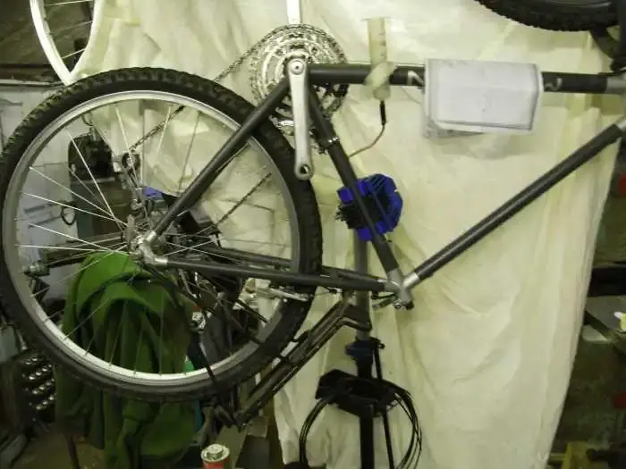

The cork is a bit of 19mm silicon hose with an expander in one end. An old head bolt and a few bit's of scrap plus a bit of threaded tapered scrap did the job. The cork just needed tightening by hand to seal, Picture two is clearly the cork.

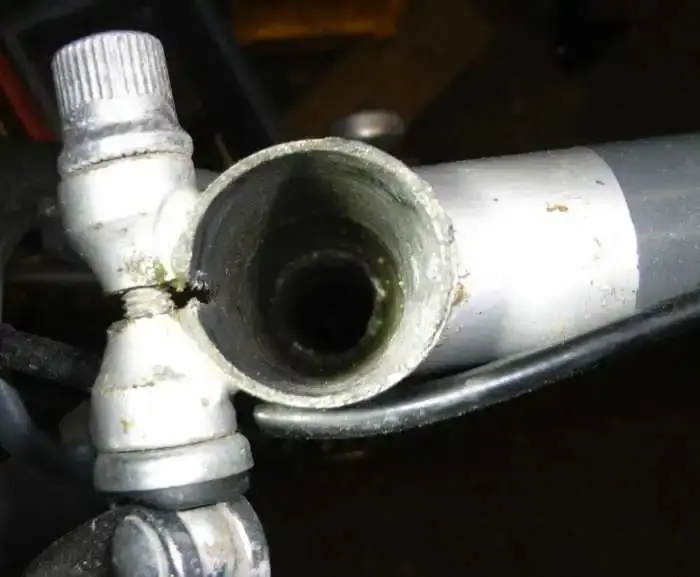

The funnel is a bit of brake pipe, a scrap of tube and an old syringe. The brake pipe is ground to a taper, wrapped with ptfe tape and screwed into the bottle bolt hole, screwed in gently as it just has to stay in place[no threads were harmed in the ******* of this seat post]. The syringe is taped to the top tube, I just poured the caustic in to the syringe. Picture three and four show the funnel.

I poured 100CC in to the seat tube, I poured it in at about 4pm. The seat tube got hot but stayed touchable, it was still hot a few hours later[still doing something]. It had started cooling down when I went in for dinner at 7pm so I left it overnight. The next day I emptied the tube and scraped the clag out of the tube with a welding rod. Then I re-corked it and filled it with cold water to flush as much of the crap out as I could. Picture five is what it looked like when I drained the seat post, what you see in the seat post is the clag, which scraped out with an old welding rod bent into a loop.

in the tube to stop it rusting. Picture 6 is the clean seat post
