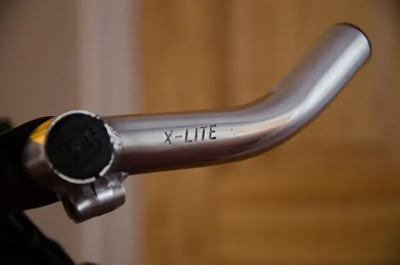

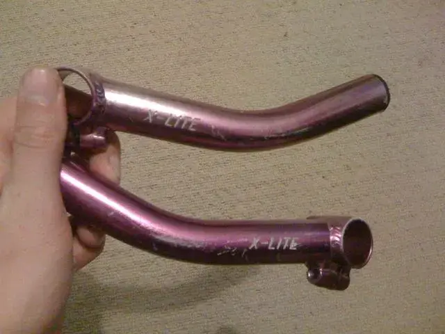

This theory works on removing anodizing from ally parts too. I got stuck in with the "Oven Pride" oven cleaner last night on some old x-lite bar ends. It's a Sodium Hydroxide (caustic soda) based cleaner which is strong enough to degrade and lift the anodising without trashing the ally (I was careful with how long I left them in solution too after seeing the seatpost vids!).
Worked a treat......

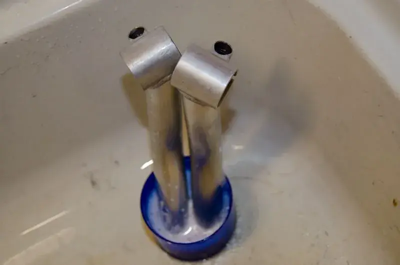

This is the stuff im using to strip stuff.
Il post a pic later
Its called 'Kiwi Kleen'
Bought in Poundland and its a heavy duty drain cleaner containing Sodium nitrate,Sodium hydroxide 52.5%
You get three sachets each one you pour down the drain and add a cup of water
SO THEREFORE :lol: Pour one sachet in a cup[because its glazed] and fill up with water.
Gives off Hydrogen and i think oxygen too so no smoking :wink:
Piece of string to dip the part into the solution and a basin of cold water to kill the reaction.
Dip the part into the cup of drain cleaner,count to 10 then dip it in the water and swirl it about a bit
As you repeat this process you will see the colour come off into the basin and the part turn a kind of a metallic brown.
I use at that point some autosol on a cloth.no need to wire wool it if it was reasonable to begin with.
I suggest you wear gloves for the polishing process as god only knows what the brown stuff is :lol: It's quite hard work doing the polishing so keep at it :D

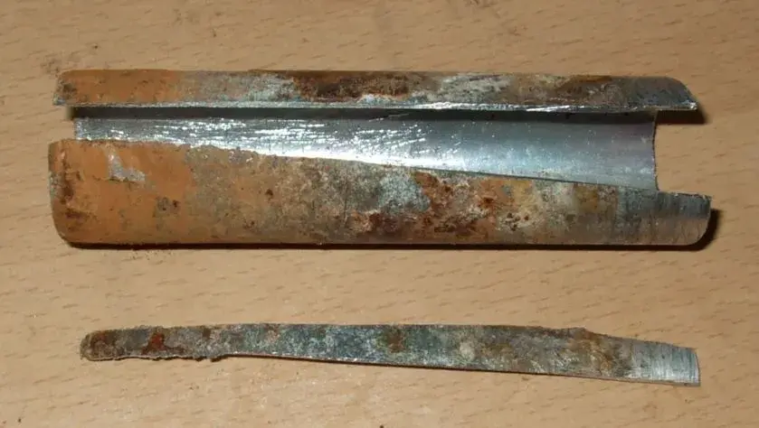

mordorf":38w8qat2 said:
I have exactly the same problem on a 94 explosif dont know if i am brave enough to do that tho :?
Try cutting it out. To be fair, he didn't have all that much inserted so he could maybe have done it too.
This one below, also from a 94 Explosif, was only about 10cm long so it was really quite easy.
Cut to leave 1cm exposed,
Make a first cut using the groove for safety
Make sure you don't quite go right through to the steel, saw straight, no rocking motion
Make a second cut
Force a screwdriver under the strip and prise it away
Clamp the exposed 1cm in a pipe wrench, squeeze it and it'll pull out as easy as you like.
It's only a high friction dust that is stopping it moving, nothing is fused
