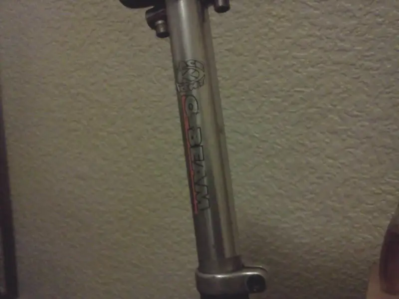

it has about 7 1/2" showing original seat post so dont know how much more there is 18" frame
OK, as you're a fellow sufferer I've just taken out my replacement 94 O'Beam to measure it (I found an identical one, which was quite lucky as they're rare). It is 345mm from the rail to the end, so if yours is showing 190 to the rail, you have c155mm inside. I wouldn't like to say whether sawing that far down would be do-able. Obviously it would be a lot more difficult, but my 100mm was quite easy. It must depend on how long a metal-specific blade you could find - mine is only 162mm, which would be extremely marginal!
