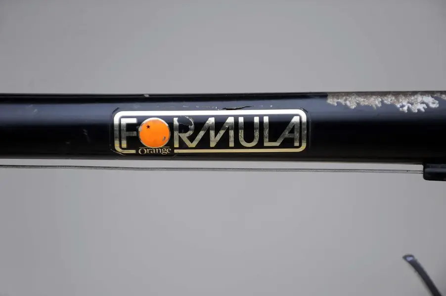

Great frame and amazing job restoring it - Found this thread searching Formula Orange as I am looking to restore Steve Wades Formula road bike and am looking for Formula top tube decals if you can point me in the right direction. I can post pics of the bike here or on another thread if anyone is interested.

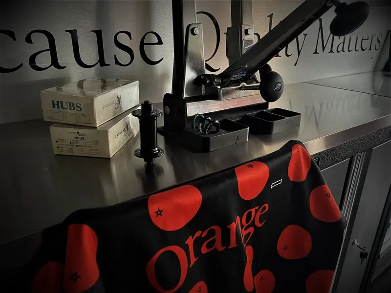

So, I thought given all the hiccups I'm having with parts delays, hoarding it, assembling it, and then adding to the thread with pics, I thought I might list my build sheet, and add updates as and when they arrive.....
I appreciate my thoughts and choices won't be everyone's cup of tea, but given the bike and its name, hopefully that's the point.
IF it ends up as per the build sheet with no more dramas or dilemmas, i will be truly amazed..!
Orange Formula -X
Commissioned by Lester Noble/Steve Wade, Fabricated by Dave Yates.
Frame-Tange Prestige Fillet Brazed frame, rear U brake fitting with X-Brace
Fork-Tange Prestige fillet brazed fork.
No rack or mudguard mounts-F.R.O-
Twin downtube bottle mounts.
Paint- Classic Neon Orange to white fade, Gold label.
Bar-Orange (Tange) Original equipment.
Stem- Orange (Tange) with under carriage cable hanger, Original Equipment.
Headset-Tange 1" Sealed.
Seatpost-Kingsbery /American Classic, Black
Saddle- Concor Supercorsa (San Marco)
Rims-Mavic M6CD
Hubs-Kingsbery/American Classic, Black
Spokes-Wheelsmith
Block/Freewheel-Suntour Winner straight through, 13-19
Cranks-Specialized Flag.
Chainrings-Specialized Chainrings, Crank caps, Black edition
Front Mech-Suntour XC9000
Rear Mech-Suntour Sprint 9000 LE
Chain-Regina Extra Corsa-Silver.
Brake Levers-XC9000 brake levers combined with gear lever, Accushift
Gear Levers-XC9000 brake levers combined with gear lever, Accushift
Grips-Period Foam-Black O/E Fitment
Cables- 2MM.
Front Brake-Scott Penderson Self Energizing front Cantilever
Rear brake-Scott Penderson Self Energizing rear U brake.
Cable hangers-Suntour.
Wheel and Seatpost Q/Rs-Kingsbery/American Classic.
Tyres- Panaracer TImbuk IIs
Pedals-Suntour XC9000
Toe Clips-GIPIEMME Crono, black
Straps- Christophe, Leather-Black
Breeze and Angell-Hite Rite.
