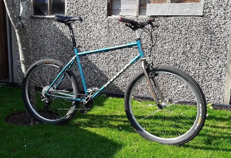

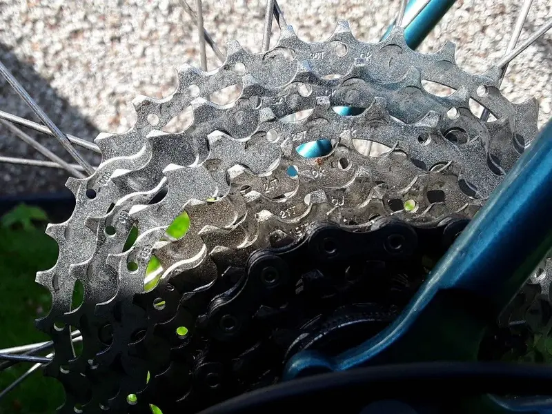

11 - 36 should be about right in my opinion but it does depend on where your riding and what tyres you have fitted ! I'm running 32 front 11-36 rear with no problems might step up to a 34 or 36 front as I never use the 36 on the rear. Also if you stick with an 11-36 you can get away with a short cage mech ! This is what I'm riding at the moment just built up with parts I had and it works for me
